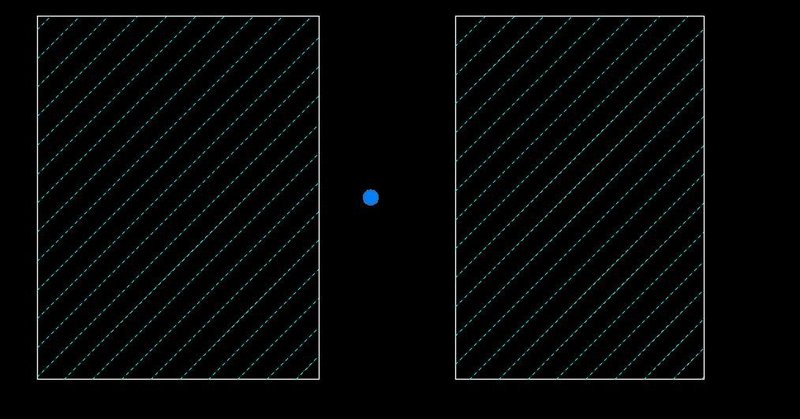

Hi, ok so I am trying to write a small lisp that will allow me to select a hatch that is Associative and has Multiple Hatches. I want to be able to separate them and not have associative but I'm still learning how to write small lisps. Been searching and figured it is time to see if maybe someone can help me out. Thank you in advance
(Defun C:FH ()
 (Command "-BHATCH" "S" PAUSE "" "" "A" "A" "_N" "H" "_Y" "")
All I get back is a "Unknown command "h" "y" etc

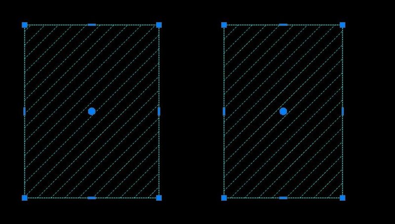

What I am trying to do is click on the Hatches (top picture) and separate hatches and not have any associative on them (bottom picture)

If you want to edit an existing Hatch, use the "-HATCHEDIT" Command. Try the following:
(defun c:HSEP (/ ss)
   (princ "\nSelect hatches to Separate and Disassociate: ")
   (if (setq ss (ssget ":S" '((0 . "HATCH"))))
         (command "-HATCHEDIT" ss "_DI")
         (command "-HATCHEDIT" ss "_H")
This will both Disassociate and Separate a Hatch.
EDIT: Note this only works with single selection. A bit more extensive code will be needed to do multiple hatches.

Quote
Pretty easy to fix, you can add more filters if required like layer and "X" which will do all.
(defun c:HSEP (/ ss hat)
   (if (setq ss (ssget '((0 . "HATCH"))))
	  (repeat (setq x (sslength ss))
	  (setq hat (ssname ss (setq x (- x 1))))
         (command "-HATCHEDIT" hat "_DI")
         (command "-HATCHEDIT" hat "_H")
(c:hsep)
Thanks Big Al. I knew it was something along those lines but was distracted by work LOL.
THAT'S IT!!!! Thank you so much guys. I guess now I'll have to break it down to see what you did so I can learn lol. Thank you so much!!
