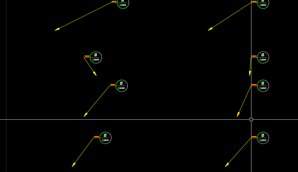

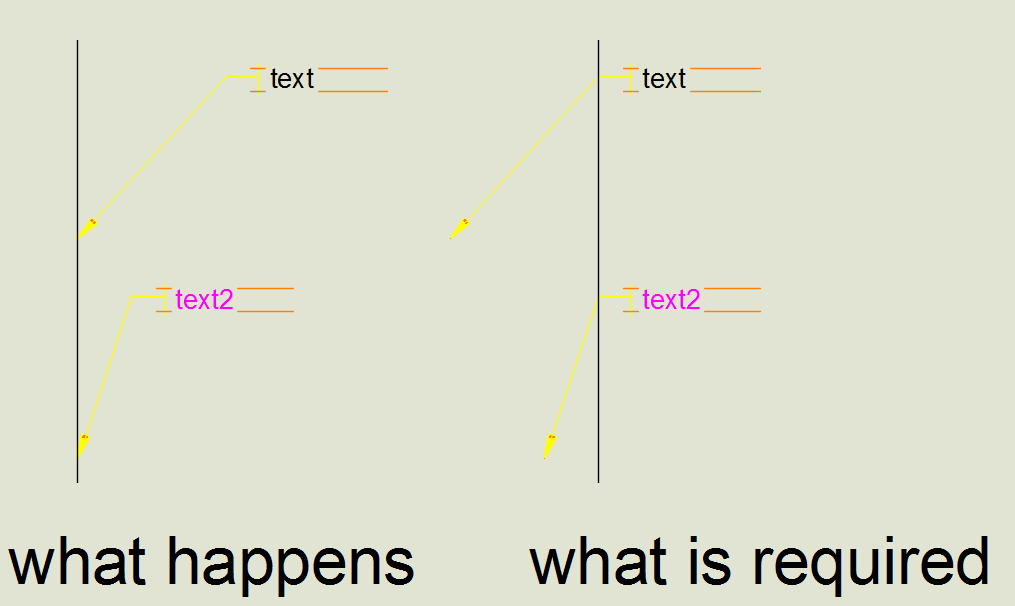

Please see below the lisp I have been using to align blocks I had referencing a line. On the snapshot above, as can be seen, the block (customized text leader block) my reference block is at the tip of the leader and not as i prefer (Position2) on this specific block.
Can someonw let me know how I can manipulate this lisp so it would take Position2 as a point to align and not 0,0 "Position". The reason for doing this is the leader pointer can be dragged but I would like the alignment to happen on that fixed "Position2". This lisp works well with my other blocks I need to align due to the proper placement of 0,0.
alternatively, is there a way, if I cannot specify "Position2", to select which point I would like to be aligned?
Thanks

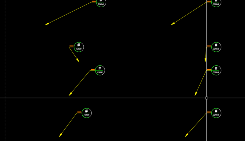

maybe my posing of  question was confusing - the annotation blocks are already on an existing drawing. The code I posted at the beginning does a fantastic job of aligning my blocks based on a vertical line I draw but not with these annotation blocks since the insertion point is defined (strangely enough) on the pointer/ leader head. That was my first mistake of defining them that way. Is there a way to modify my lisp to not take the insertion point as a reference to align rather me choosing a point.
the snapshot below is when I run my "alit" lisp:
If you look at lee-mac.com and get his dynamic property lisp, if you look at  Block Name: "Tx - Leader avec notes - 11x17 - Anglais" "position 2 X" you can change this value very easy, just pick a X point then pick your blocks change to this value a line is not needed.
You may want 2 versions ? A Y version also
I just looked at "Properties" of the block and changed values so you know the dyn variable name.
Ok had another look and some problems, the dynamic variable name is different for the blocks but similar control point. You have two choices make a block look up list that has the say point name, alternatively make the blocks all the same way and use the same dynamic name for the common point. For me the latter method.
You need to get the insert point then look at X value
;sample code starts here  Block Name: Tx - Leader avec notes - 11x17 - Anglais
(setq ptx (car (getpoint "Pick X point")))
(while (setq blk (vlax-ename->vla-object (car (entsel "Pick block"))))
(setq insx (car (vlax-get blk 'insertionPoint)))
(setq x (- ptx insx))
(LM:setdynpropvalue  blk "Position2 X" x)

It worked for me but only the 1 block name that had position2 x they all lined up. I copied the block multiple times.
Ok I used a different version of lee-macs dynamic block lisp.
