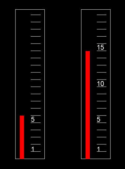

Jim Clayton Posted November 14, 2019 Posted November 14, 2019 This is going to be really confusing until you look at the attachment. I'm trying to make a Dynamic Block of sorts for what is essentially a ruler/scale/indicator that gets mounted to a liquid level chamber. It has mounting hardware on the top and bottom and a logo at the top. The shorter/longer it is will be the deciding factor in how many numbers are visible on the indicator. My goal is to make it so that as the Logo moves up or down, the numbers either become visible or covered up. I'm trying to figure out if this is possible and if so, how? I realize none of this makes any sense. Please look at the attachment for clarification. INDICATOR.dwg Quote

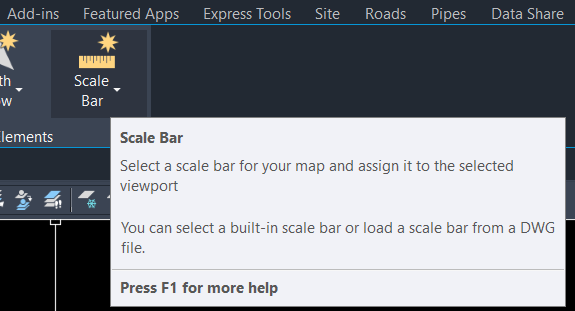

BIGAL Posted November 15, 2019 Posted November 15, 2019 There are sample "Scale" dynamic blocks its in the Ribbon, may be usefull start, you can definitely change visibility states in a dynamic block. Is it easier to do a block with multiple attributes and just reset attributes to " " so not visible maybe 20 attributes. Pretty easy to do a repeat of num atts with increment using lisp. Quote
Jim Clayton Posted November 15, 2019 Author Posted November 15, 2019 Thanks Al. I appreciate the help, however I'm not sure this is quite what i'm after. It's hard for me to give a proper explanation because I don't recall coming across something like this before. The only thing I can relate it to is a Dynamic Block, which seems simple enough to do with the repeating tick marks of the ruler. The area where I run into a mental roadblock on it is the numbers. Some of them are repeating but only until they get to the next number on the scale, then it's a new number. I can't figure out how to get around that. I welcome suggestions though. Also I'm running ACAD2014...I'm not sure I have the above feature. Tks. Quote
Jim Clayton Posted November 15, 2019 Author Posted November 15, 2019 Maybe if I make the top portion a block and somehow incorporate something similar to the Wipeout command so that as the block moves over it, it becomes hidden? idk Quote
ronjonp Posted November 15, 2019 Posted November 15, 2019 I'd make a block of a section and assign the text an attribute. Then they could easily be stacked and code could fill in the numbers. Why do you show so much detail? Quote

Jim Clayton Posted November 15, 2019 Author Posted November 15, 2019 That's not a bad idea actually...I may try to run with that. Thanks. And to your question, these go on the outside of Liquid Level Chambers for process applications. They have to be visible and precise so that operators can keep track of Levels (as I understand it...I'm just a cad monkey). But I'm working on overhauling the entire process for drawing these because it currently sucks and the blocks are a nightmare and unnecessarily time consuming. Quote

Jim Clayton Posted November 18, 2019 Author Posted November 18, 2019 See I was initially thinking along the same lines with vertical array. I made a similar block for horizontal flex armor a while back and thought it could be the same principle but in the opposite direction. I can manage the repetition of shapes fine, but the area where I keep hitting a mental roadblock is the Numbers. I'm not sure how to get the two to tie in together aside from leaving blank spaces to fill in, but that seems like it's almost just as time consuming. Certainly the collective genius of the CadTutor forum can figure out a way around this. Quote
BIGAL Posted November 19, 2019 Posted November 19, 2019 (edited) The horizontal lines would have the "Ft" "in" 3 6 & 9 as part of a block the Actaul Feet text easiest done as attribute and update in order as the array will create in an order but would have to explode probably the array. You could insert as a block add 0 1 2 etc then group them so if erase or move all go. array block1 given distance = howmany array block2 given distance = howmnay x=-1 repeat how many = distance x=x+1 insert block att1 =0 next 1 2 3 add to Y vertical spacing end repeat all done Edited November 19, 2019 by BIGAL Quote
