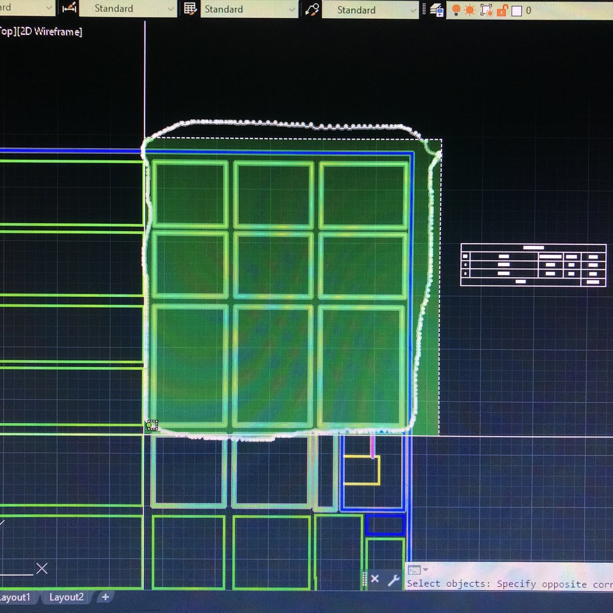

I got the attached code from Mr. Bigal. I'd like to thank him very much. The code calculates the entire length of that layer. What I want is not the whole length in that layer, but just the calculation of the chosen ones. I tried to do it, but it didn't work out. Can you help.

I may not have been able to explain my problem because my English wasn't good. The code you gave me worked very well for me. I just want to calculate a fraction of the project. The code receives the sum of the entire length in that layer. I want him to choose the sum of the lengths in the region I chose. Would you look at the attached project.

It needs a different approach if you want to pick some plines layer1 then pick layer2, then pick more on layer1 again. It would be  easier to use a block with attributes, area & layer, then sum all of them up. That is start again with code.
Some one else may have something that matches what you want. Pick plines add to table if layer exists in table add to totals.

The problem is understanding how many squares you are picking.
Why not pick all ?
How many times pick squares same colour ? Add Areas ?
Do you want all 1 at a time with total  in table ?
I know language is a problem.
Post a new sample dwg. Draw lines to table so see what has been picked.
Problem is understanding request not answer.
