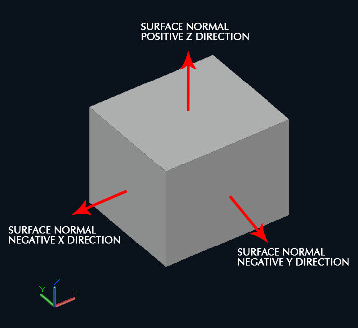

Cad64 Posted December 27, 2019 Posted December 27, 2019 I'm not understanding the question and I'm not exactly sure what you're attempting to do? Why are you concerned with Normals in a 2D drawing? With 3D objects, the Normal is an imaginary ray that is perpendicular to the plane of the the objects surface. So, if you have a flat surface that is sitting on the XY plane, it's Normal will be pointing straight up in the positive Z direction. It makes no difference if the surface is sitting at Z-1.0 or Z1.0, the normal is still pointing up in the positive Z direction. The direction of the Normal will depend on which way the surface is facing. If you rotate the surface 45 degrees along the X or Y axis, then the surface normal will be pointing in that direction, or if you rotate the surface 180 degrees, the Normal will now be pointing in the negative Z direction, but this really only applies to 3D objects. The Normal of a 2D circle will look and behave the same regardless of which direction it is facing. Can you provide more information about what you're trying to do with your drawing? Quote
