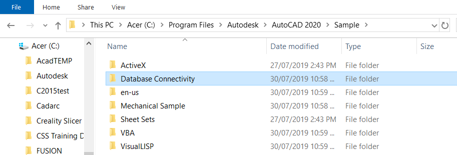

If you google Autocad has the ability to use SQL, so you can say open a ESRI database, same with Access. It has been around for years.
