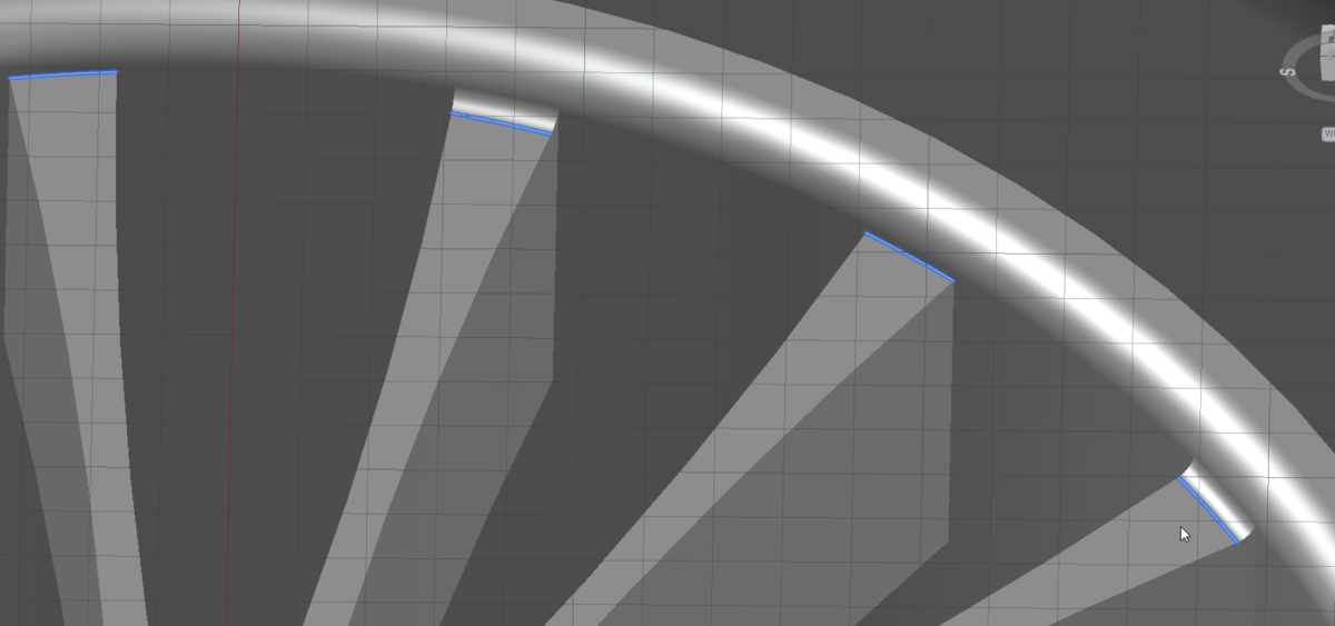

Any way to fix this ?
I want to round the edges on the rim, but some edges are skipped for unknown reasons even when they are exclusively selected.
Also I'd like to know if there's any way to avoid these odd issues. The rim object was created in Autocad 2017 and then imported to Autocad 2018

Could you try the same with the perpendicular edges?  (straight lines) - because acad 2018 does not like them either it seems.
Thanks in advance

Got it working. Sort of. I have to do every edge separately 🤨 and it doesn't work consistently. Upgrading to 2020 did not help much. 🤬
