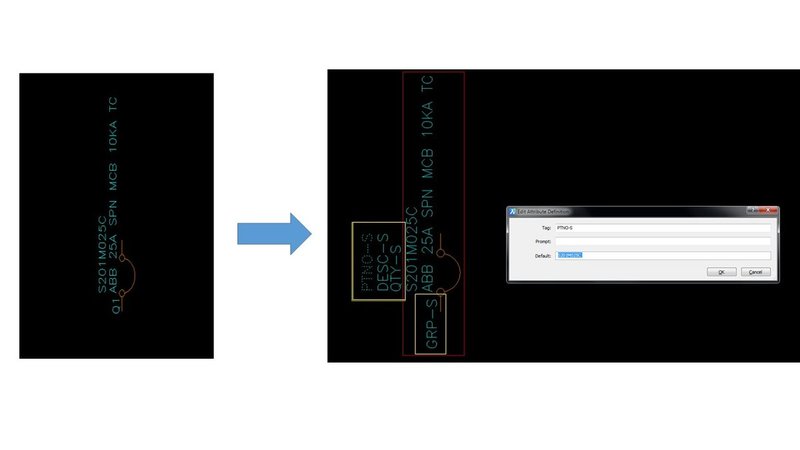

This is a sample of a block that I have. The part highlighted in red is the block, the parts highlighted in yellow are the attribute tags in that block. What I would like is to be able to create a table where I can draw the "DESC-S" AND "PTNO-S" attributes, count the number of similar blocks in the same drawing and put the information into a table. I need this as I use several numbers of the same blocks in a drawing, and I don't want to count each part manually.

I do have a multi block to table that counts blocks and sorts on up to 5 attributes deep, so  can have one block name but with different attribute values counted. Post a sample dwg and will show result. I will state though it will be a pay for lisp. But is very cheap. I am looking for real dwg's to test on.
There are various block count programs out there but most only count a block name not subsequent attribute values.
Try Dataextraction Autocad command, lee-mac.com has a good block count.

Ok here is a example make a table. There is lots of get attribute examples out there its your school assignment.
