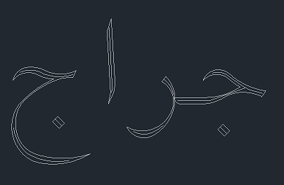

asos2000 Posted February 5, 2020 Posted February 5, 2020 This is the font be note that this font use English keyboard to type Arabic letters. For example {vH[ Give this word XARAB.SHX Quote

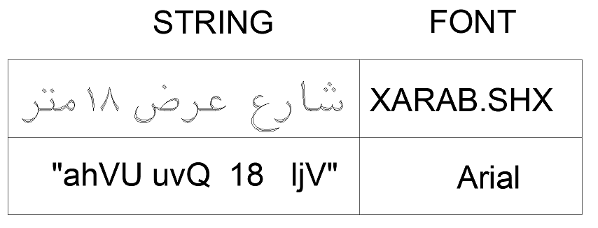

BIGAL Posted February 9, 2020 Posted February 9, 2020 asos2000 it should be possible to do a key remap of the text from the shx to a Arabic TTF bit involved though. What happens when you change the text style to an Arabic one. Do they match. "ahVU uvQ 18 ljV" Quote
asos2000 Posted February 9, 2020 Posted February 9, 2020 3 hours ago, BIGAL said: asos2000 it should be possible to do a key remap of the text from the shx to a Arabic TTF bit involved though. What happens when you change the text style to an Arabic one. Do they match. "ahVU uvQ 18 ljV" This is the string with 2 different fonts Quote

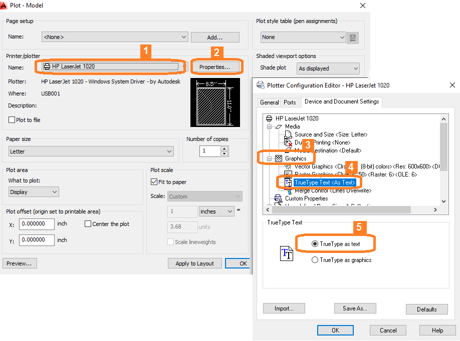

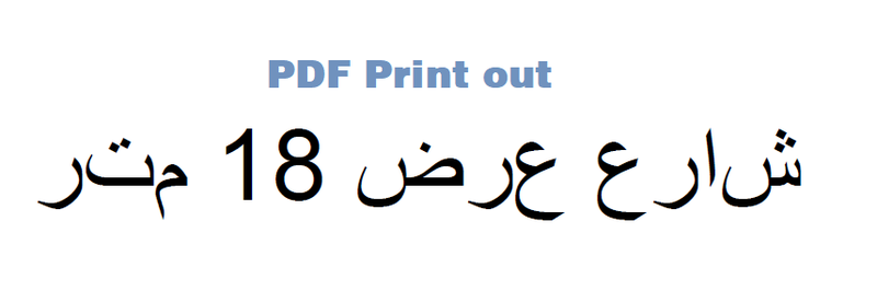

asos2000 Posted February 9, 2020 Posted February 9, 2020 Why is the Arabian use this font type?! We can use Arial font type in Multitext using Arabic Keyboard, but when we plot in PDF (for example) the output is not correct. Of course there is solution but not every one knows this solution, we have to change plotter configuration. for example Quote
mannybmanago Posted February 10, 2020 Author Posted February 10, 2020 (edited) @asos2000, you are exactly right. they use this for directly printing the AutoCAD to the plotter/printer or even in PDF without changing the printer configurations. Also the DWG to PDF.pc3 doesn't support the solutions for the true type fonts. I am not good in usinMOH_SITE_NAME - P200.pdfg "js" and I am still stuck in how to write the codes output a text file or csv for all my data. The main goal is to automate the "Parcels" land deeds in an A4 format as attached. I was able to bring the Arabic text close to the parcel for visual cues and print it later. Also, it should be fed into a database or CSV file at the moment. The printing also shows that the TTF issue using the DWG to PDF.pc3. I can't find a way to Automate the printing using the Adobe or bluebeam pc3. Printing happens per parcel. BR, Manny Edited February 10, 2020 by mannybmanago Quote

mannybmanago Posted February 10, 2020 Author Posted February 10, 2020 @asos2000 the requirement is to output the files in CSV or a text file so it can be put in a database. The A4 print I sent will be the equivalent pdf for documentations. For now, I was able to extract and automate the task to to the layout per parcel. But to have an equivalent CSV or text file is the issue because of the Arabic text. The output is "ahVU uvQ 18 ljV" "ahVU uvQ 18 ljV" and not correct. Quote

asos2000 Posted October 8, 2021 Posted October 8, 2021 Sorry KumKum I do not know how to use but for plotting Arabic letters first Start Printing Ctrl + P Then follow this Quote
