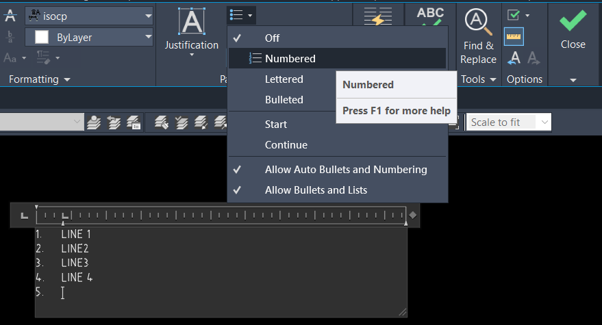

BIGAL
I just referred to Word as it was easier to make the numbered notes then paste into Mtext. I don't think word allows referenced items either. Mtext has numbering.
