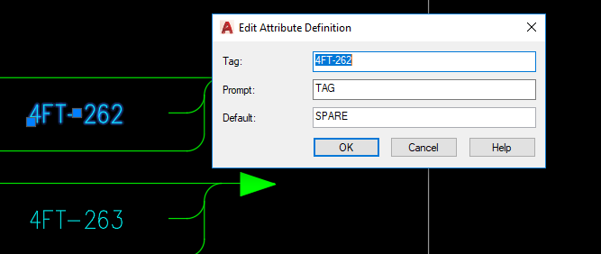

I have a bunch of free floating attributes that need to become text. When I convert them to a block and use burst the values are lost since the instrument numbers were typed into the "tag" field. Here is a picture.
Free floating attributes are created by someone that does not realize that they are creating a problem. More like PEBCAK rather than a quirk.
What's wrong with a little LISP to solve OIE?
TAG2TEXT(sp?) used to a part of my daily arsenal against bad CAD.
