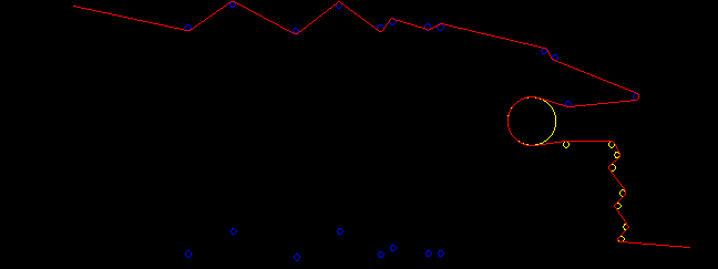

Hey guys I have come a long way since my last post. My lisp has become more complex. I added a .dcl and I have been stuck for days on a minor (feels major to me) problem. When running the routine there is a option box with 3 options anytime you exit the main loop. When user chooses the "add idler" option for some reason the polyline seperates into 2 segments instead of one long one. This is driving me insane..What am I missing???
To test you will need a dwg with many circles and 2 layers "web" & "idler". The code is intended to be user friendly for inexperienced autocad users to be able to draw a "web path"
I am also open to any poor practice code fixes anyone wants to suggest. For example I know (command "-layer" "SET" "WEB" "") is probably not the right way to change layer in a lisp.. Thanks in advance for any help!

Have no direct solution for your problem because I have no idea what the drawing looks like on which it is suppost to do its magic. An idler is some kind of gear google tells me so it has to do something with mechanical drawings , that much is clear. Draw a couple of circles , ok ,  I can do that but in what configuration? Like polar or something else? My point is , post a picture with a before and after situation , if possible with the points you have to pick numbered in pick order. Maybe then someone knows what to do. I have no mechanical background but I'm sure a lot of members do and will be probably able to help you. I think its something small and simple.
With the little testing I was able to do on a ramdom flock of circles your routine does seem to work fine apart from the add idler problem so nice job even I know didly about gears and stuff 😉
As far as the coding itself , everyone has his or her own style. Whatever works best for you is just fine. I like to put as much information on one line (horizontal and compressed) as possible while others like to put everything on a separate line. Its not because its better but I'm just too lazy to scroll. like

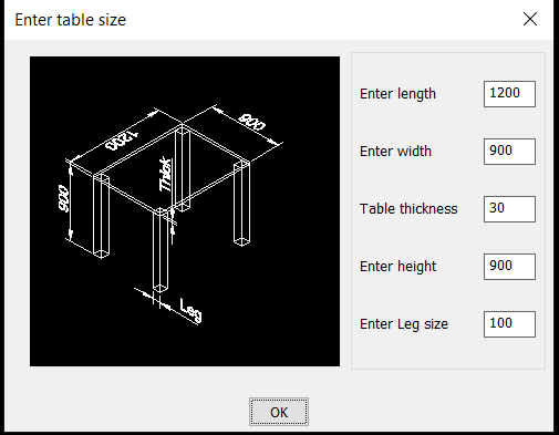

My $0.05 This is a bit shorter version of DCL Cancel button could be added. Just download Multi Radio button.lsp from here at Downloads. The second again is a different version asking for input but with image option.
(if (not AH:Butts)(load "Multi Radio buttons.lsp"))
(if (not but)(setq but 1))
(setq ans (substr  (ah:butts but "V"   '("Please Choose" "Vdraw" "Add Idler" "Undo" "End web"))))
(setq ans (AH:getvalsimg "D:\\Acadtemp\\furntable" 40 (list "Enter table size" "Enter length" 5 4 "1200" "Enter width" 5 4 "900" "Table thickness" 5 4 "30" "Enter height" 5 4 "900" "Enter Leg size" 5 4 "100")))

rlx I can't upload an actual pic or .dwg of any of our presses (that would probably get me into some trouble). I attached a dwg and a pic that I use for testing. The "idlers" can be added all over the place and no "web" path is ever the same. This adding an idler makes no sense to me why it ruins my polyline and makes 2 segments. Pedit after adding the idler still joins all 3. in the command line I see 2 segments added to polyline. The next time through the loop everything appears to go normal until.....

WHY WHY WHY!!!?  Ha ha I am reading the same code and following it step by step over and over and not finding anything.
press.dwg
I sort of know what goes wrong with your routine. My first thought when I saw your routine was the use of the entlast function but I couldn't test (prove) it because I didn't understood what the routine was suppost to do. Now that I know how it works I placed a breakpoint (the hand symbol or F9) at the last pedit in your code , (command "pedit" "m" pl1 pl ar "" "y" "j" "" "") , and inspect the variables. When routine is paused at the breakpoint , double-click variable pl1 and click on the microscope button and it will say its a line. Do the same for pl and for ar. And then you will see that pl is not a polyline but a circle. And circles wont join...
I've done it... There were numerous problems with the code... I think I sorted out all...

  (defun undoend ( / dcl_id w h )
    (setq dcl_id (load_dialog "undoendidler.dcl")); load dialog
    (if (not (new_dialog "undoendidler" dcl_id)); test for dialog
      (exit); exit if no dialog
    );_ if
    (setq w (dimx_tile "im"); get image tile width
          h (dimy_tile "im"); get image tile height
    );_ setq
    (start_image "im"); start the image
    (fill_image 0 0 w h 5); fill it with blue
    (end_image); end image
    (action_tile "add" "(setq idl 1)"); set value
    (action_tile "end" "(setq inn 2 end 2)"); set value
    (action_tile "undo" "(setq inn 3)"); set value
    (action_tile "accept" "(done_dialog)"); if O.K. pressed close dialog
    (action_tile "cancel" "(done_dialog) (setq inn 1)"); if CANCEL pressed close dialog
    (start_dialog); start dialog
    (unload_dialog dcl_id); unload
  ;**           Start of idlers               **
  (if (not (findfile "undoendidler.dcl"))
      (setq fn (open (strcat (getvar 'roamablerootprefix) "support\\undoendidler.dcl") "w"))
      (write-line "undoendidler : dialog {label=\"Vdraw\";" fn)
      (write-line "  :boxed_radio_column {label=\"Type\";:radio_button {key=\"add\";label=\"Add Idler\";}:radio_button {key=\"undo\";label=\"Undo\";}:radio_button {key=\"end\";label=\"End web\";}} ok_cancel; " fn)
      (write-line "  :row {:image {key=\"im\";height=3.0;width=20.0;}:paragraph {:text_part {label=\"Designed and Created\";}:text_part {label=\"by V\";}}}}" fn)
      (close fn)
  (if (not web)
    (setq web (getstring t "\nSpecify WEB layer <\"WEB\"> : "))
  (if (not idler)
    (setq idler (getstring t "\nSpecify idlers layer <\"IDLER\"> : "))
  (if (= web "")
    (setq web "WEB")
  (if (= idler "")
    (setq idler "IDLER")
  (while (not (snvalid web))
    (prompt "\nSpecified WEB layer name is invalid...")
    (setq web (getstring t "\nSpecify WEB layer name : "))
  (while (not (snvalid idler))
    (prompt "\nSpecified idlers layer name is invalid...")
    (setq idler (getstring t "\nSpecify idlers layer name : "))
  (setq snp (getvar 'osmode));	Gets users current snap setting to reset on error or at end of draw
  (setvar 'osmode 512);	Sets osnap to nearest
  (setq pea (getvar 'peditaccept)); Gets current accept PEDIT mode - if 1 it's assumed that PEDIT prompting "Yes" are invoked; if 0 "Yes" token must be specified in PEDIT command
  (setvar 'peditaccept 1); Sets PEDIT mode to 1
  (setq cl (getvar 'clayer))
  (setvar 'orthomode 0); turns off ortho
  (if (not (equal (getvar 'viewdir) '(0.0 0.0 1.0) 1e-8))
      (prompt "\nType PLAN command and restart routine...")
      (exit)
  (vl-cmdf "_.UNDO" "_Begin")
  (setq px (/ (getvar 'viewsize) (cadr (getvar 'screensize))))
  (setq ll (mapcar '- (getvar 'viewctr) (mapcar '/ (mapcar '* (getvar 'screensize) (list px px)) (list 2.0 2.0))))
  (setq ur (mapcar '+ (getvar 'viewctr) (mapcar '/ (mapcar '* (getvar 'screensize) (list px px)) (list 2.0 2.0))))
  (if (not (setq ss (ssget "_W" ll ur (list '(0 . "CIRCLE,ARC") (cons 210 (trans '(0.0 0.0 1.0) 1 0 t))))))
      (if (tblsearch "LAYER" idler)
        (setvar 'clayer idler)
        (vl-cmdf "_.-LAYER" "_M" idler "")
      (prompt "\nCreate starting idler...")
      (vl-cmdf "_.CIRCLE" "\\" "\\")
      (if (tblsearch "LAYER" web)
        (setvar 'clayer web)
        (vl-cmdf "_.-LAYER" "_M" web "")
      (vl-cmdf "_.UNDO" "_Mark")
      (initget 1)
      (setq pt1 (getpoint "\nPick START point : "))
  (if (not pt1)
    (setq pt1 (getpoint "\nPick START point / Right Click-ENTER - UNDO ALL : "))
  (if pt1
      (initget 1)
      (setq pt2 (getpoint pt1 "\nPick a Circle or Arc : "))
      (vl-cmdf "_.UNDO" "_Back")
      (c:idlers)
      (setq end 2 inn nil)
  (if pt1
      (vl-cmdf "_.LINE" "_non" pt1 "_tan" pt2 ""); draws the line
      (setq epl (cons (entlast) epl));	adds last line list for join segments later
      (setq p1 (trans (cdr (assoc 10 (entget (entlast)))) 0 1) p2 (trans (cdr (assoc 11 (entget (entlast)))) 0 1))
      (setq pll (cons p2 pll) pll (cons p1 pll))
      (setq pt1 nil pt2 nil)
      (setq end 1 inn 1)
  (while (<= end 1); *******************Start Outer loop*******************
    (draw); runs draw function - Inner loop
    (if diag
        (undoend); opens undoend function (the pick box)
        (setq diag nil)
    ;******************** UNDO IF ************************* If user chooses undo option from pickbox
    (if (= inn 3)
      (cond
        ( (and (entlast) (= (cdr (assoc 0 (entget (entlast)))) "LINE"))
          (prompt "\nRight Click-ENTER - UNDO ALL; Any other key for normal UNDO...")
          (if (and (or (= (car (setq gr (grread nil))) 25) (and (= (car gr) 2) (= (cadr gr) 13))) (not ss))
              (c:idlers)
              (if ss
                  (initget 1)
              (if (not pt1)
              (if pt1
                  (initget 1)
                  (c:idlers)
              (if pt1
                  (setq end 1 inn 1)
        ( (and (entlast) (= (cdr (assoc 0 (entget (entlast)))) "LWPOLYLINE"))
          (setq pll (cddr pll) inn 1)
        ( (and (entlast) (= (cdr (assoc 0 (entget (entlast)))) "CIRCLE"))
          (setq inn 1)
      );_ cond
    );_ end if
    ;******************** Add idler *********************** If user chooses add idler option from pickbox
    (if (= idl 1)
      (progn; then do this
        (setq idl (getpoint "\nChoose where to add idler : ")); choose location for idler
        (setq idl (if (osnap idl "end,cen") (osnap idl "end,cen") idl))
        (vl-cmdf "_.CIRCLE" "_non" idl "\\")
        (setq idl nil inn 1)
      );_ progn
    );_ end if
  );******************************************************End Main outer loop
  ; end web*********************************************After user chooses end web option
  (if (= inn end 2)
      (initget 1)
      (setq pt1 (getpoint "\nCHOOSE EXIT POINT on idler : "))
      (initget 1)
      (setq pt2 (getpoint pt1 "\nChoose Endpoint : "))
      (vl-cmdf "_.LINE" "_tan" pt1 "_non" pt2 "")
      (setq pl1 (entlast))
      (setq en1 (trans (cdr (assoc 10 (entget pl1))) 0 1))
      (vl-cmdf "_.LINE" "_non" (car pll) "_non" (cadr pll) "")
      (entdel (entlast))
      (vl-cmdf "_.ARC" "" "_non" en1)
      (setq ar (entlast))
      (while (or (not (entget (car epl))) (= (cdr (assoc 0 (entget (car epl)))) "CIRCLE"))
        (setq epl (cdr epl))
      (vl-cmdf "_.PEDIT" "_M" (car epl) ar pl1 "" "_J")
      (while (< 0 (getvar 'cmdactive)) (vl-cmdf ""))
  (*error* nil)
);_ end idlers
