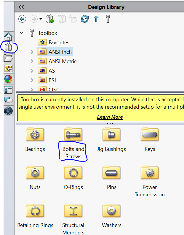

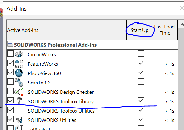

Are you talking about the SW Toolbox Library?
At the top, the little "gear" icon, pick it and select Add-Ins
Make sure the Start Up check box is checked
You will probably have to restart your SW
As stated above, I download often from McMaster
