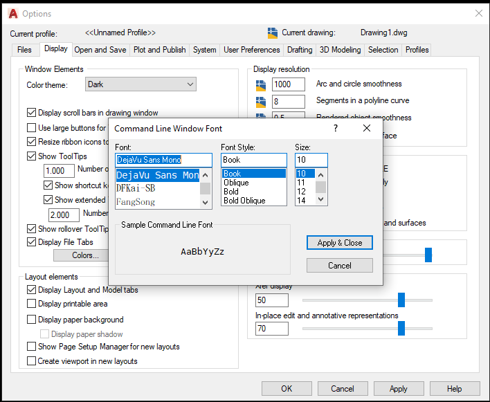

brandalf_the_semiGray Posted March 5, 2020 Posted March 5, 2020 In C and C++ we have the ability to customize the text width of a block of text so that things will be printed nicely to your output stream in the same "column" if you will. Is there anything like this in autolisp? As you can see in the clip below, the text is not aligned very nicely. I want to know whether there's a way to align "columns" easily, or if i have to get creative with my print logic. Thanks in advance, Brandon Quote

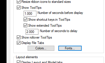

pkenewell Posted March 6, 2020 Posted March 6, 2020 @brandalf_the_semiGray NOTE: You CAN change the command line font in the AutoCAD options to a Monospaced font. Quote

brandalf_the_semiGray Posted March 7, 2020 Author Posted March 7, 2020 (edited) I got it sorted out by padding the output with spaces. Thanks everyone. I think this is an ideal situation because I don't have to change any system settings to use my routine on everyone's computer. I want the interface to be simple and zero setup aside from loading the lisp. Padding isn't 100% perfect, but its organized and readable enough to suffice. Again, I appreciate all the ideas and pointers. Part of me was hoping there were stream operators like in C and C++ that make it easy to format command line output. That might be a fun project to start in on... write a library of functions for command line output formatting. I'll bet the text font even has a system variable somewhere that can be changed via code. I don't suppose anyone knows of any libraries for creating charts and histograms in cad itself? Edited March 7, 2020 by brandalf_the_semiGray Quote
