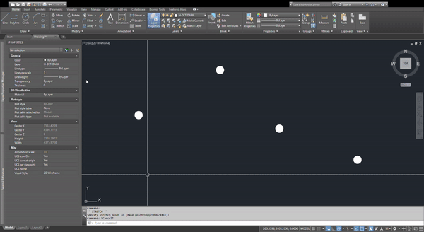

Hi guys,
I'm a pretty new learner when it comes to doing reactors. I tried doing a LISP routine whereby it draws a rectangle between the insertion points of two blocks. I set my reactors so that when moving the block, the rectangle will update itself as shown below:
But something just starts to screw when I undo, because I've always set my AutoLISP to Break on Error. As good practice, as long as the error doesn't show up, I know that I'm doing the right thing.
What's really happening to the reactors when you undo, or am I missing something?

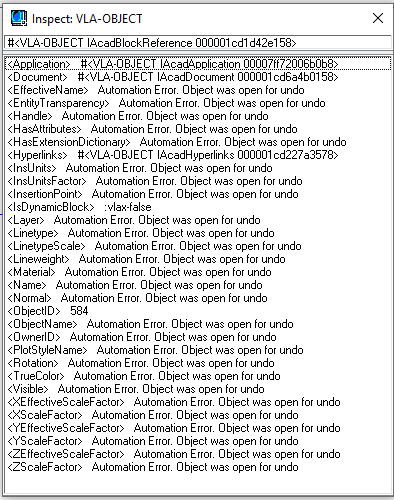

Probably your issue is related to setting start/end undomarks of the active document within the callback function(s).
But if you are curious about your question - here is some observation:
Modifying a circle's radius and performing undo -

So for short - a bunch of documentLockModeWillChange / documentLockModeChanged, objectOpenedForModify / objectModified events happen, along with
commandWillStart / commandEnded with argument ("U") - which stands for UNDO.
Reason for the double commandWillStart / Ended is because one event is called from a :vlr-Command-reactor and the other is from :vlr-Editor-reactor, since they have the same events.
If I couldn't solve your problem with Start/Undo Marks,
I would probably include a command-reactor to trace for   :VLR-commandEnded . ("U") , so I would 'auto-process' all the linked objects within your object reactor.

Sorry for the extremely late response... I didn't understood it then, but now I do. When I read your quote, I think the issue is:
When I run the Undo command, the :vlr-commandwillstart fires up, thus inspecting the object that triggered the reactor yielded the following:
I didn't at all thought it would fire the :vlr-modified event, hence failed... I wanna ask though, where can you get that step-by-step event that's fired when a certain action is taken? Perhaps I can try to work around it if I can get this information.
This is just my practice on using reactors... I know this can be done by associating the dimension to the block as opposed to using reactors (even though associating dimensions also uses reactors), but this just serves as practice...
I don't know if this is a good approach to avoiding the undo... basically setting a global variable as T when the undo command starts, and then setting it back to nil when it ends. And in the vlr-modified reactor, I use an if function to execute what the modified function does if the flag is inactive. I've included a video below to show how this animation works.
