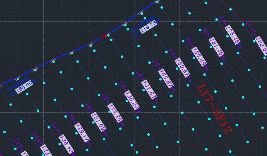

I need a routine which labels polyline length with this arrange: "incremental prefix" + "automatic field value of polyline length" + "meter as suffix".
the output will be something like this : "R1=[100]m"
i will be very thankful if you could help me

This is a sample of my drawings. all I need is to label those green polylines with this order: "an incremental prefix" + "field value of polyline length" + "a suffix".
I've used Lee Mac's NumInc for incremental prefixes and added length field manually.

This will solve all your problems. Selection sequence will determine which polyline is first and which is last. Upon prompt on selection, you can type F and select by fence.

Just out of curiosity, that seems to look like a riser (blue line) by which it goes to the manifolds (orange blocks) into every floor and then into every apartment (the blue blocks). I do hydraulics too so it looks super familiar to me. If that's true, that's quite the shape of the building (red polyline).
It also seems like the water meters (blue blocks) are drawn on every vertex of the polyline. If that's so, this may help you:

It works like a charm! 👍👍
Thank you very very much Jonathan.
Man, you made my day, this routine helps me doing my drawings hundred times faster!
Actually this is a pressurized irrigation system project with Manifolds (blue polylines), Laterals (purple polylines), Risers (blue blocks) and Gate valves (orange blocks),
also the red polyline is cadastre of a farm.
