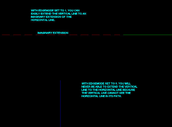

Cad64 Posted July 6, 2007 Posted July 6, 2007 Change your EDGEMODE variable to 0. You will want to change it back to 1 after you finish trimming these lines. Quote

Cad64 Posted July 6, 2007 Posted July 6, 2007 See my previous post. It's a simple switch of the EDGEMODE variable. From the Autocad Help Files: 0 = Uses the selected edge without an extensions 1 = Extends or trims the selected object to an imaginary extension of the cutting or boundary edge Your polyline has many edges, so when you select it as the cutting edge and try to trim the intersecting lines, the lines are trimming to the imaginary extensions of the cutting edge. Switch EDGEMODE to 0 and you will be able to trim the lines easily. Just set it back to 1 when you are finished trimming. Quote

amanda phillips Posted July 9, 2007 Author Posted July 9, 2007 hi Thanks everyone for all of your help, i changed the edgemode variable to 0 and it worked !!!! Fantastic..... Thank you Amanda x:D x-x:D x Quote
New2CADmike Posted July 16, 2007 Posted July 16, 2007 See my previous post. It's a simple switch of the EDGEMODE variable. From the Autocad Help Files: 0 = Uses the selected edge without an extensions 1 = Extends or trims the selected object to an imaginary extension of the cutting or boundary edge Your polyline has many edges, so when you select it as the cutting edge and try to trim the intersecting lines, the lines are trimming to the imaginary extensions of the cutting edge. Switch EDGEMODE to 0 and you will be able to trim the lines easily. Just set it back to 1 when you are finished trimming. why would I want to bring the edgemode back to 1..??where would you use it at the 1 setting?? Mike Quote
Cad64 Posted July 16, 2007 Posted July 16, 2007 Setting EDGEMODE to 1 allows you to Trim/Extend to an imaginary edge. For example, say you have a horizontal line and a vertical line. You want to Extend the vertical line up to the horizontal line, but the vertical line is not directly underneath the horizontal line so it will never meet the horizontal line at any point. With EDGEMODE set to 1, you can extend the vertical line up to an imaginary extension of the horizontal line. Does that make sense? Quote
New2CADmike Posted July 16, 2007 Posted July 16, 2007 Yes it does make sense!!...Until this thread i didnt know there was a variable of edgemode...Mine has always been set to 0,because I did not know it was there to change..Thanks again Cad 64..Mike Quote
