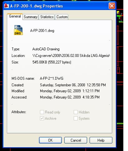

Hi all
I have problem with xrf’s files we are using AutoCAD 2009
The problem is sometimes when we are open the base file give us the massage it is reed only but no one open it
My be this option in server or the cad program have any one this problem before
Regards,

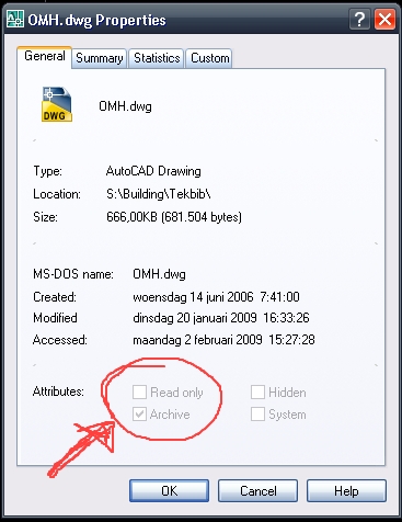

Look up the file in your explorer and see if the file properties are set to read only?
If not you can make sure that no-one is using it by typing whohas in the commandline in autocad!
Try this for start
Give me this massage ” User unknown “
Then nobody is using it!
have you checked the file properties?
But this happened also when open it from outside the AutoCAD
I still think that your read only file is in your file props. can you post a screen shot of the file props!
This answer come from my friend “CCOWGILL “he side
( Does someone have a drawing open that has the base drawing attached to it? is the setting for demand load xrefs set to enable with copy? )
And I think this is answer because I found it as he says
Thanks for your cooperation and I’m happy to talk with you have a nice day ATTILA THE GEL
