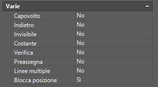

Hi, I did it! with a stroke of luck I found an example that looked like my problem!
I have not yet understood correctly, I have to study why, but I solved it by changing the properties of the attributes ... I attach the image and block.
Regards!
1562469830_exampledynamicblockscaletext2attributes.png.842458ad1af6a9c087645e2d589f6115.pngexample dynamic block scale text 2.dwg
