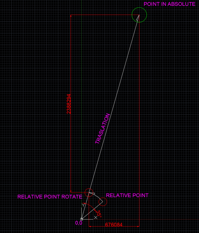

Hello I would like to know if it is possible having texts that are relative coordinates with their corresponding prefix E: and N :, select those texts, identify the numerical values and perform the operations to transform them into absolute ones, giving the angle of rotation that would be from point 0 , 0, and the displacement distances and replace the original texts, I have managed to make an application that inserts the values in a leader, but I wanted to do the above but it is beyond my knowledge.
I attach the application that I have made and a drawing with what I would like to achieve

Hi, thanks for answering,
the initial texts indicate relative coordinates, but from a schematic point, specifically from an isometric drawing, not real they are simply informative, and what I wanted is that numerical value to apply the transformation to absolute coordinates
Thanks

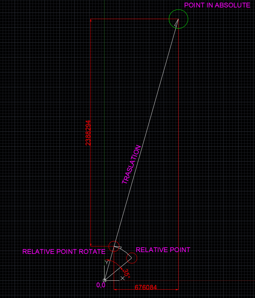

Hello againcoordinates_transf.dwg, Jeje i am sorry.
The Points E: and N: are the X and Y coordinates.
Absolute value i mean coordinate UTM (or WCS)
They are coordinates of points in an isometric drawing.
The lisp that I did was so that from a real point in relative coordinates (or UCS personal), I put the real coordinates (WCS).
But in this case what I would like is that a series of texts that represent X and Y coordinates, but in relative values, will perform a transformation operation, given the angle, and the displacement in X and Y.
That in the lisp that I made those values are:
Angle: 35º with base point 0,0
X (H) 676083590
Y (K) 2388293870
But they could be changed.
What I had thought was, that when applying the lisp, it would read the values that contain E: and N: and identify them as X and Y coordinates respectively, and apply the transformation to the numerical value, and substitute that value
The problem is that I don't know how to extract the values and then apply the formula to them and then substitute them.
The transformation formula I have applied in the lisp, but I attach an excel with the values.
Maybe it's a little complicated hehe
Thanks

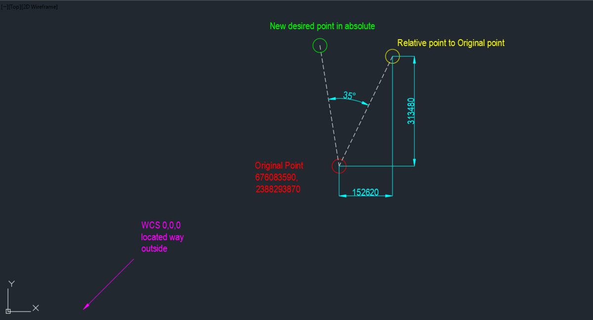

Took me a while to understand it... I believe I'm interpreting this right based on your example:
I thought the base angle was 0,0 in terms of WCS, but it's to the original point
Edited by Jonathan Handojo
5 minutes ago, nano said:
Hello, it's more like that
So where is x" and y"?
It looks similar to how I sketched it
Yes, the x and y coordinates are exactly where you indicate, but what you have set as the original point would be 0.0imagen.thumb.png.536e269695a1e4e5555c67f8eec0c4f7.png
It won't yield the result you pointed out in Excel. The one I sketched is literally drawn to scale. If the original point was at 0,0 the new point yielded will be way too far from the result in your Excel.

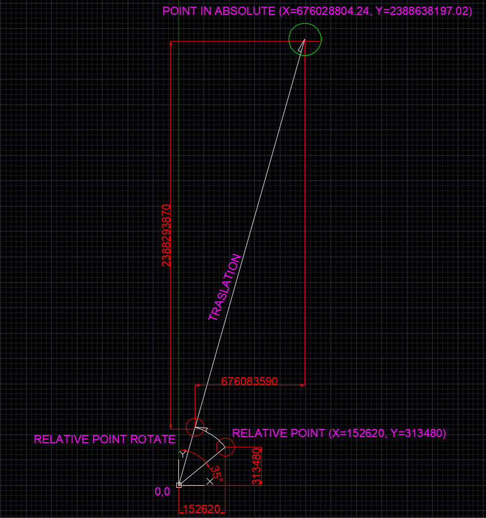

In any case, after many thinking and evaluation, I've come up with a solution for you:
(defun c:yourcommand ( / ang angoff dist eastlabel newpoint newval northlabel orgpoint srche srchn txt txtlab vale valescale valn valnscale x y)

Make sure that the units for the coordinates and displacement are the same, else the result will be wrong
Thank you, you are very kind, I have tried it and it does not make the substitution of the texts, after introducing the angle it does nothing, but I think that with your work I will try to do something.
Thank you very much again
Sorry, I have tried another dwg and  change it perfectly, it must be a variable problem
Thank you very much
Edited by nano
Apologies, it must be due to the effect of dimzin, text may be playing a bit wrong. Also, ensure your text is not in a locked layer.
Here's an updated one with the help of Lee's Parse Numbers function that I tweaked a little bit. I hope the calculations are right:
