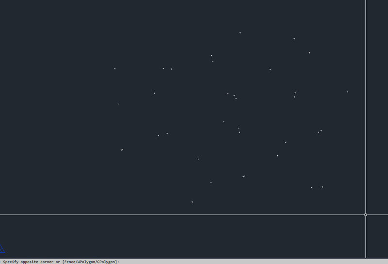

The following problem is happening to me.
I when clicking with the mouse these annoying points appear, when moving or making zoon they disappear.
What you are seeing are "blips". It was an early AutoCAD drawing aid and still persists today, but not used by most people.
The best way to turn them off is to set the System variable BLIPMODE to 0.
