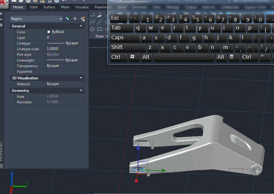

h.mo Posted May 8, 2020 Posted May 8, 2020 hi, i am trying to make a mould of a section of a 3D step file i have, i followed this video on YouTube but when i try to remove the 3D object from the "plate" using the solid, subtract function, i get a message saying: "no solids, surfaces or regions selected". has anyone had a similar issue? Quote

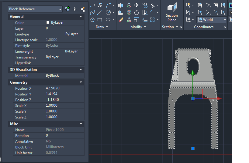

Cad64 Posted May 9, 2020 Posted May 9, 2020 When you imported the step file, it may have come in as a block. Try exploding it and see if Autocad recognizes the solid model. Quote

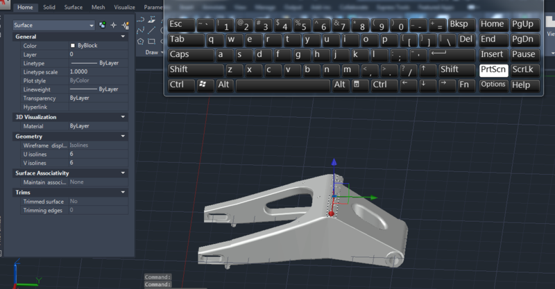

h.mo Posted May 9, 2020 Author Posted May 9, 2020 2 hours ago, Cad64 said: When you imported the step file, it may have come in as a block. Try exploding it and see if Autocad recognizes the solid model. hi i tried to do this, i exploded the model and it seemed to have separated into multiple components instead of becoming one solid piece. so when i try "solid, subtract" i have to select every individual piece of the object. and it still shows the same message Quote
Cad64 Posted May 9, 2020 Posted May 9, 2020 53 minutes ago, h.mo said: hi i tried to do this, i exploded the model and it seemed to have separated into multiple components instead of becoming one solid piece. so when i try "solid, subtract" i have to select every individual piece of the object. and it still shows the same message Then my next guess would be that the imported step file is a mesh instead of a solid. You could try the CONVTOSOLID command. Quote

h.mo Posted May 9, 2020 Author Posted May 9, 2020 8 hours ago, Dadgad said: At the commandline, when you start the EXTRUDE command, select the MOde option, where you should set it to 3D Solid. You seem to have it set to create SURFACES. I believe that is all you need to do to get it sorted. Those midcommand settings options are important, and can make all the difference. I hope that helps you. Late to the party, just realized that video was the one you were watching, not created. I never work with Meshes nor Surfaces, but I think Cad64 is probably on the right track! If you select the Object, how is it described in Properties? Can you post your .dwg? So we can take a look and help you figure it out, real time? 8 hours ago, Cad64 said: Then my next guess would be that the imported step file is a mesh instead of a solid. You could try the CONVTOSOLID command. hi, this is whats shown in the properties tab. Quote
Cad64 Posted May 9, 2020 Posted May 9, 2020 9 minutes ago, h.mo said: hi, this is whats shown in the properties tab. Ok, so my first guess was correct. When you imported the step file, it came in as a block, which means it needs to be exploded. So what does it show in the Properties tab after you explode it? Does it say Polyface Mesh? Quote
h.mo Posted May 9, 2020 Author Posted May 9, 2020 12 minutes ago, Cad64 said: Ok, so my first guess was correct. When you imported the step file, it came in as a block, which means it needs to be exploded. So what does it show in the Properties tab after you explode it? Does it say Polyface Mesh? once i explode it, the object becomes 370 + separate parts. if i highlight all the parts and go to properties, there are regions and surfaces. Quote
Cad64 Posted May 9, 2020 Posted May 9, 2020 Well, at this point my only recommendation would be to recreate the object in Autocad using the Solid Modeling tools. I don't think there's any way to stitch all those surfaces together to create a solid model, unless they've added some new functionality in 2020? Maybe someone else has some ideas. Quote
