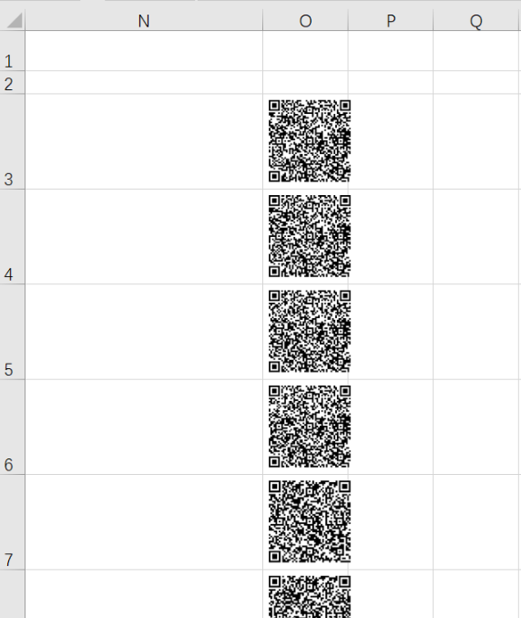

As the title, I need to get a QR code picture of the cells in the excel file as the picture blow ,but I can only get the value of cell at present,can someone help me?

Are the pictures really "in" the cells or just in front of them?  YOu can access pictures via their object name.  For example,
ActiveSheet.Shapes.Range(Array("Picture 1")).Select
same idea which i got from a recorded macro :)
The issue if too many images, OLE dialog keeps popping up not sure any sysvar to control?

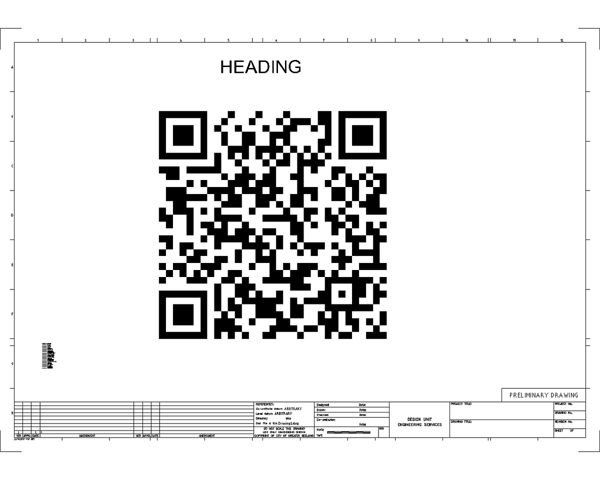

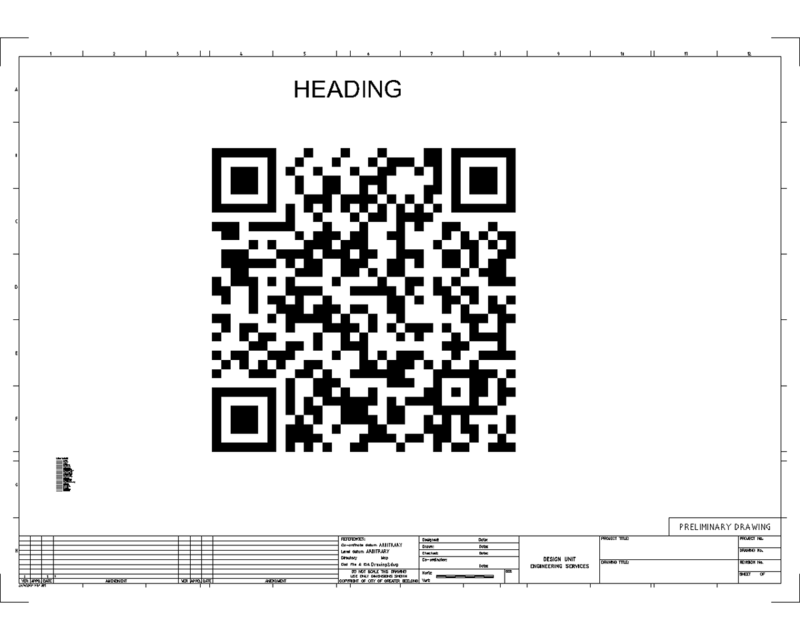

QRCODE  bundle makes the QRpatterns just type words etc . I think I got it from Autodesk exchange.
Edited by BIGAL
Do you mean there is a special QR conversion program provided by Autodesk?
Where can I get it ? thanks
I am sure it's really in the cell, Because when I use the cursor to move to the corresponding cell, I can copy and paste the QRcode in it

QRCODE  bundle makes the QR patterns just type words etc. I think I got it from Autodesk exchange.
no luck if plugin only supports 2016-2020?
IIRC, ZWCAD Qrcode app is built-in, insert as block if exploded each pixel 1 unit length x 1 unit width of LWPOLYLINE (square)
see also Qrcode arx
