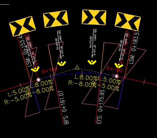

Same thing but with the location of a road sign
along a 3D civilian lineup . . .
As it is shared here, I also want to share
And above all, that they improve it:
(defun c:SENALES-LISTA (/ fl ofl s sn nb linetx dat p a fk op lado pos2 lt c_pos1 c_pos2 num entero decimal enterox1000 aa b c d e absx)
  (setq fl (getfiled "Select Data File *.csv: " "" "csv" 4)
        ofl (open fl "r")
        ldat ())
Edited by SLW210
Added Code Tags!
You dont need Excel to do this if you want warning signs on a bend you can find the curve in the alignment, re CIV3D, much simpler if it is a pline or have kept the original pline when making the alignment.
Just needs say some rules about placement 1st sign dist from TP then spacing etc.
If you have CIV3d can get the chainage of the TP point and use that with "getpointatdistance" for the signs.
