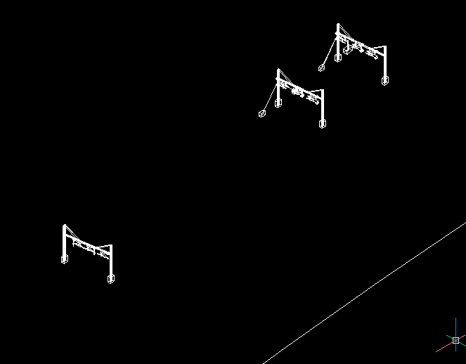

Hello,
I insert 3D blocks thanks to one of Patrick's lisp, which is the IXL lisp, the blocks fit very well, but there is just one problem, it's that I don't know what the angle is , so that the block is perpendicular to the polyline. So if anyone can help me clear this up, thank you in advance.

I thought I posted this already have you double posted ? It has a hard coded test csv file you will need to change.
; Take a csv file of text details and make in Cad
; By Alan H May 2018
(defun c:Tram-posts ( / fname str  newlst pt angl isblk oldsnap oldaunits )
(defun alg-ang (objpl pnt)
  (angle '(0. 0. 0.)
     (vlax-curve-getfirstderiv
       objpl
       (vlax-curve-getparamatpoint
         objpl
         pnt

(setq pt (VLAX-CURVE-GETPOINTATDIST obj dist))
(setq  angl (alg-ang obj pt))
(setq pt (polar pt angl off))
(setq pt (list (car pt)(cadr pt) z))
(command "-insert" blk pt 1 1 angl)
