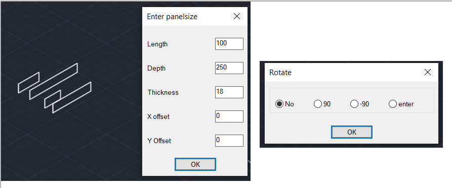

For me I would not do it this way I would ask questions and draw the panels possibly as plines, there are rules about your tolerance on the panels else shelves will not slip in. The desired end result cupboards book case etc lends it self more towards a few custom routines. Adding components via say height above and width.
Yes want Z you can use thickness for this rather than going down the full solids path. The table should be sorted then compare so say x is 15 material thickness Y and Z are values. The -15 is a mirrored block easy fix.
Have a look at this draws a simple table in full 3d.
Lastly I will forward onto some one for their comment in mean time any one out there got cupboard lisp. I know commercial software is out there.
Thanks for your help. I feel it may be difficult to go the 3D table route (your pic above) as the options in shelving will be massive. There eventually will be glass shelves, drawers, veneer cladding, hardware, etc. and many more items populating the shelves. I feel individual lisp routines stuck together may help out in piecing the item together.... Any way, this 2d sample sent to you was done with a simple auto lisp routine written by me..... (Some scales in the drawing may be weird since it was done just as a sample)

I used a pline 1 x 1 then thickness 1 this is the same as a solid to make the block. So X Y Z scale works.
The issue is not in getting the x  y z scales but rather the sorting algorithm's that's where the time comes in, do you want each panel sorted by longest length X Y then Z ? Just change this to write file for csv but note no totals.

For me something like  X Y as Z is accept or change then from point x and y, then rotate 90 ? The values are saved between each go so could be just change y offset for multiple shelves etc.
The dcl are available here as they are not hard coded. Rather a user library routine.

Thinking more could  add a block as each panel is made giving a panel number and sizes rather than x y z scale and produce a panel list.
