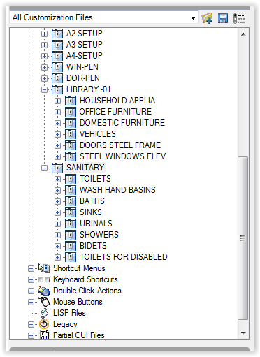

1  I am busy to add customising to my ACAD.CUI file (Menu Bar - see 3 x Attachments)
2  Screen Shot 01 - I am adding LIBRARY-01 and SANITARY as new Menu's with sub-menu's

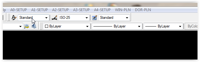

3  Screen Shot 02 - They should appear after the item DOR-PLN

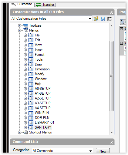

4  Screen Shot 03 - Shows the added sub-menu's
During the course of adding new items like NAME, MACRO and BITMAP icons to the IMAGES part, I pressed "APPLY" and everything came out fine
   and the items appeared on the MENU BAR as they should
But somewhere along the line (for some obscured reason) I must have left out an item and upon selecting "APPLY" the items disappeared from the
   the MENU BAR. The items however are still part of the customised tree but they do not appear on the MENU BAR
How do I get them back to display on the MENU BAR

Is it possible that you've changed the menu in one workspace and made a different one active? Did you save the .CUIX file before you closed the CUI window?

Q1 yes use menuload etc to load a custom menu.
Q2 you can turn menus off in workspaces so the desired menu is probably turned off in your current work space,  select your workspace in CUI editor then right side Edit, then back to left and look for tick on in your menus, apply OK. Save workspace again.
