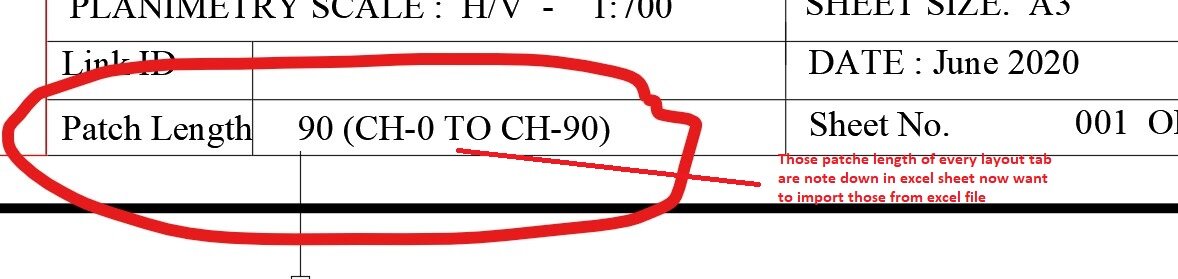

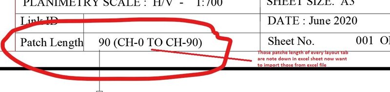

Thanks for your kind reply i didn't want to change layout name i want to import patch length which was already note down in excel, if you check my dwg file so i mention in first sheet patch length which is noted down in excel  "Patch Length     90 (CH-0 TO CH-90)" other sheets having different patch length in compression to excel sheet i also attaching screen shot kindly help me
Providing the text is at same location on ever sheet then easy just go to each layout check its number/name and make text. What is your layout name if its like layout1 then add that to excel. If the layout name is all over the place you can use layout order instead.
Do a csv export then its simple read the csv and (setvar 'ctab layoutnumber) (command "text" Pt .......)
Use lee-mac parse csv to make a list of the layout details. Then use foreach on the list very simple.

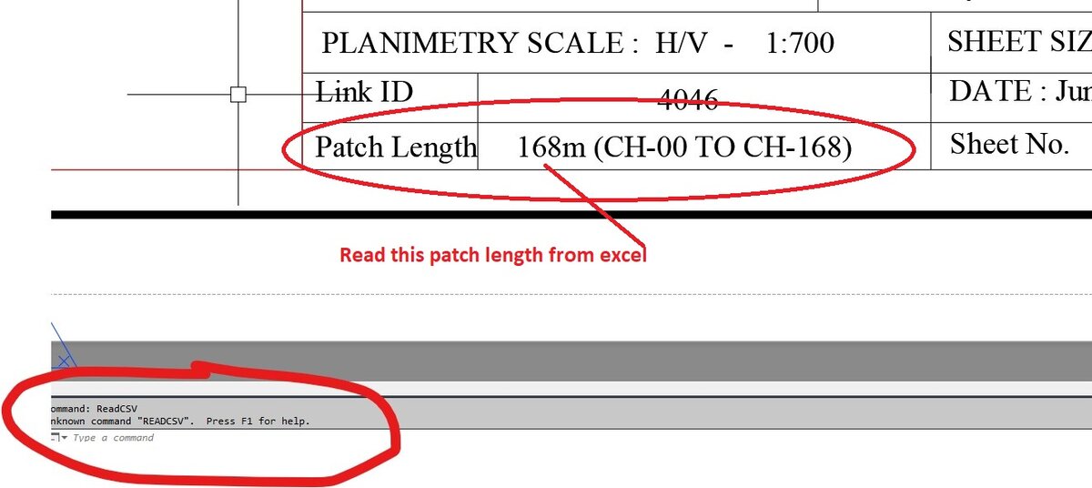

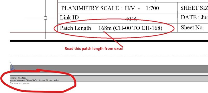

i tried readcsv lsp but not able to use can u please check it in my attached dwg,

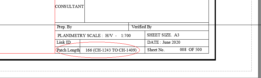

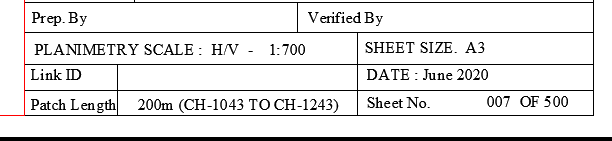

Please clear , at your dwg , the patch length is at al 8 sheets
And a like , not equal text, is  at the XLS
So, the task to do is: replace the  text at the DWG , by the text at the XLS .
It seem to be that you are updating the dwg as it had be changed adding a new  LAYOUT's  between 2 or more existing layouts.
Maybe if you could explain WHAT you have , and not HOW to do , it will clear us.
