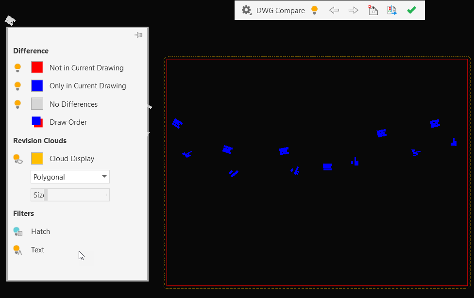

Look into the COMPARE command .. assuming you have a later version of AutoCAD.
Hi @ronjonp
      Firstly Thanks for looking on my request,
Actually i have Autocad 2014 & compare command is not working for me ...is there any other way to use this compare command in my Autocad, please suggest me.
Thanks.

Try this .. you'll need to copy drawing1 into drawing2 and burst.

Hi @ronjonp
Thank you so much for your help :)
First i copied Drawing1 & pasted over Drawing2 & using command BURST, bursted all... then i run the command FOO,
after that i got error as "  ; error: Automation Error. Null extents "  & getting stopped. i have attached screenshot.
Edited by amb2301
Now i tried working like.....before BURST, i manually deleted all the Block attributes ( H: T: E: A:) Shown in above screenshot...then i Bursted the drawing & run the FOO command, it worked fine ....& shown up all the Non-Duplicated :)
