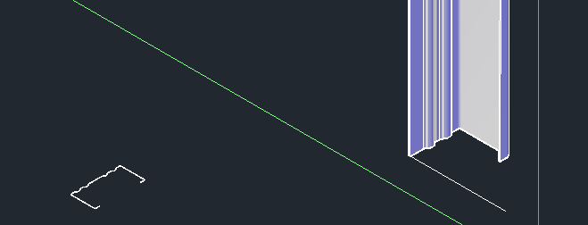

I am a beginner in AutoCad and really struggle with the attached drawing.
I have managed to make the bottom profile a solid but I just cannot manage to convert the top polyline to a surface.
My goal is to use the loft tool to create a solid profile changing from the bottom shape to the top shape 2800mm path in Z axis.
I created the top polyline from the bottom polyline I just flattend the two sides by rotating and drawing four new lines.
A step by step explanation of what I am doing wrong will be highly appreciated please.
My steps were,
Join the lines and archs to create a polyline, result were 44 lines joined
Pedit width of polyline to 0.3
Then tried to convert without success
Thank you
Profil.dwg
Not sure why dont use loft cut shapes in half then worked some one smarter than me may know.
