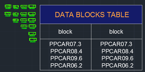

I WANT TO INSERT EVERY  BLOCK NAME (BLK) AND COUNT IN ONE SINGLE CELL

(SETQ ptLst '("BLK_1 : 12" "BLK_2 : 3" "BLK_3 : 5" "BLK_4 : 20" ))
(setq xs1R (LM:lst->str ptLst "\n "))
(vla-settext mytabe row 4 (strcat xs1R))

 (SETQ ptLst (mapcar
            '(lambda (a)
               (strcat  (car a) "." (rtos(cdr a) 2 0))
            lst2
(setq L_RC (LM:lst->str ptLst "\n "))

      SupportDrawingTable     (vla-addtable (vla-get-block
                                  (vla-get-activelayout
                                   (vla-get-activedocument
                                    (vlax-get-acad-object))))
                                      (vlax-3d-point basepoint)
                                 2
                                 2
                                 1
                                 30))
     (setq js (entlast))
						(vla-setcelltextheight SupportDrawingTable 0 0 3)
						(vla-settext SupportDrawingTable 0 0 " DATA BLOCKS TABLE")
			                	(vla-put-regeneratetablesuppressed SupportDrawingTable :vlax-false)
			                        (mapcar '(lambda (y)
					  	(vla-settext SupportDrawingTable 1 (car y) (cadr y))
					  		(vla-setcelltextheight SupportDrawingTable 1 (car y) txtsize))
						 	'((0 "block")(1 "block")))
