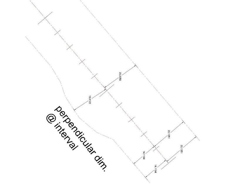

Perpendicular Distance between 2 lines every X meter
I have two lines (not parallel) let say 1km lenght each line.
I need to know the distance (Perpendicular) between those two lines every 5 meters, there is a lisp that can do it?
output should be in table format in excel or text file.
Many thanks

perpendicular to center line? . distance step at center line ?
;;  ;;https://forums.autodesk.com/t5/visual-lisp-autolisp-and-general/how-to-calculate-road-widths-between-a-given-distance/td-p/9681443

HI
This LISP is more accurate to operate

Sample.dwg
On 9/11/2020 at 5:22 PM, devitg said:
For better understanding, and, maybe, get further help, please upload such sample.dwg
As far as I know, ACAD only can edit DWG.
please find the attached sample dwg
