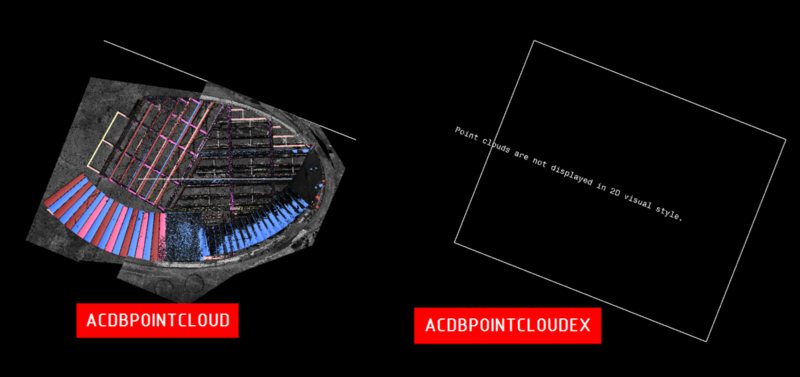

I'm also noticing a variety of other strange behaviour when trying to working with point clouds in ACAD2015...
1.  A point cloud reference (.RCS) which was originally inserted on ACAD2014 cannot be modified by ACAD2015 ribbon tools (and is also missing from the Point Cloud Manager).
2.  Upon "LIST"ing the point cloud object... I see the one inserted in ACAD2014 is called "ACDBPOINTCLOUD", while the one inserted in ACAD2015 is called "ACDBPOINTCLOUDEX".  I suppose ACAD sees and treats them as different type of objects.
Edited by lamensterms
More unusual behaviour...
When using NWCOUT from ACAD2015, I get the following results:
1.  ACDBPOINTCLOUD elements display fine in Navisworks (ACDBPOINTCLOUD are the result of attaching a point cloud to DWG using ACAD2014).
2.  ACDBPOINTCLOUDEX elements do not display in Navisworks (ACDBPOINTCLOUDEX are the result of attaching a point cloud to DWG using ACAD2015).
