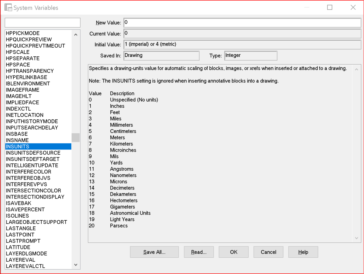

tombu Posted October 21, 2020 Posted October 21, 2020 In addition to the UNITS & -UNITS commands check out the system variables INSUNITS, INSUNITSDEFSOURCE, & INSUNITSDEFTARGET which affect insertions. Quote

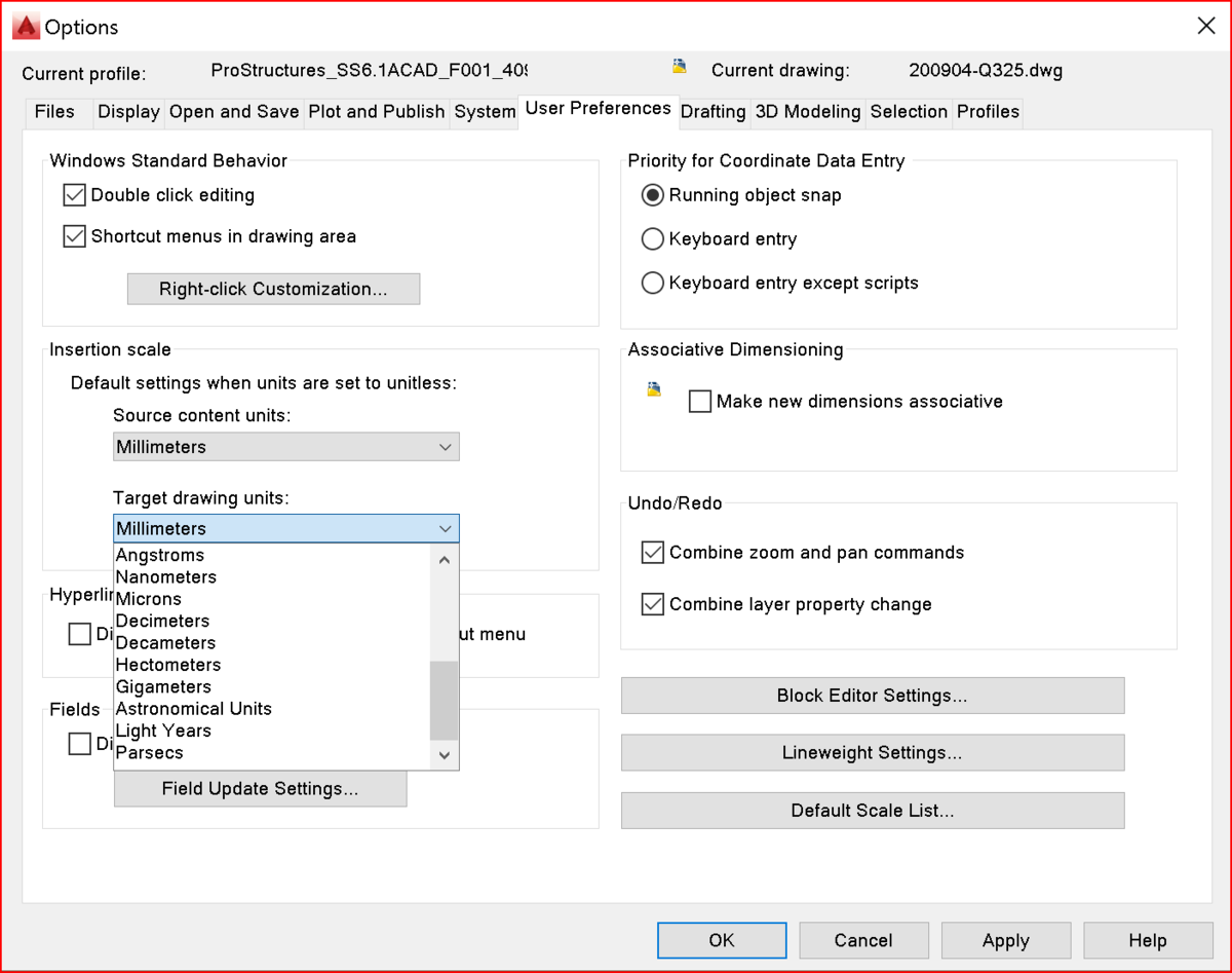

Mr.Alex Posted October 21, 2020 Author Posted October 21, 2020 Thank you tombu, much appreciated. The UNITS, -UNITS & INSUNITS were all correct for me. The INSUNITSDEFSOURCE, & INSUNITSDEFTARGET ones were set to mm. I have changed them to metres. I understand what INSUNITSDEFSOURCE does, but less so INSUNITSDEFTARGET. Any thoughts on the -DWGUNITS being incorrectly set to mm for me, rather than metres? Is it likely to cause me any problems? I'm inclined to think not given how long it's been like that and how many projects I've worked on with other consultants. If others were having problems with my drawings I would have heard about it years ago. But perhaps I will correct it and either put up with that 'this drawing contains custom objects' message or just start saving everything in the current version. Quote

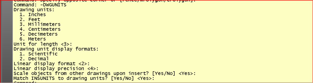

Mr.Alex Posted October 21, 2020 Author Posted October 21, 2020 Thank you tombu. I'm still a bit unclear about what changing the units in the -DWGUNITS command actually does, is anyone able to explain that to me? Quote
Dadgad Posted October 22, 2020 Posted October 22, 2020 (edited) The -dwgunits command is a wonderful tool to simplify and clarify the settings in your drawing; either one you are about to create, or one which you receive and upon which you might be working. If I am not mistaken, I believe the default length units for an ISO template (.dwt) are mms. Meaning that if you enter a value of 1,000, you will be drawing a line one meter in length. A dimension showing 1000 in the Text means it is one meter long. Architects tend to prefer working in Meters, so they would likely choose a Drawing Units value of 6, in the previous commandline history. Drawing a line of "1" then means it is one meter long, and a dimension which reads as 1.5 means one and a half meters. If Han Solo was working on a drawing he would likely opt for the Linear Distance PARSEC, it is just a matter of what one has in mind, and how quickly one expects to get there. Look at the Primary Units tab in OPTIONS, to help you understand the other available commandline questions/options in the command. I hope that helps you get an overview. Many hundreds of drawings to check at lightspeed, good luck with it. As you continue on your CAD journey, the SYSVDLG command and dialog will prove immeasurably helpful. The definitive resource for more quickly learning to use the software, and to make it work in the way that will be best for you. I favor just scrolling with my cursor through the list,as doing it that way will open momentarily each dialog, you'll learn a lot! Edited October 22, 2020 by Dadgad game changing addition Quote
Mr.Alex Posted October 22, 2020 Author Posted October 22, 2020 Thank you very much for your reply Dadgad! I like the look of the SYSVDLG command, but after a bit of looking I think that isn't available on LT. Shame! So my templates have been in 'mm', as far as the setting -DWGUNITS is concerned anyway, but I have been drawing in metres (1unit = 1m). I have had the insertion scale set as 1m in the UNITS command. I'm certain if others working on projects have had problems with my drawings that they would have come back to me by now given it is probably 1000s of sites, so I'm still a bit unclear what effect changing the units in the -DWGUNITS command actually has. Perhaps it just relates to inserting blocks?! Anyway, I think I will change the -DWGUNITS setting to metres in my template for new jobs, because I like things to be 'right' if possible. Many thanks Quote
Dadgad Posted October 22, 2020 Posted October 22, 2020 I apologize, I failed to notice that you are using LT. I was able to confirm that LT doesn't have SYSVDLG, too bad, as it is really a great tool. Start with an ISO template, set all the units how you want them to be, Text styles and dimensions how you like them, any favorite layers and other things, leader styles, etc. Once you have what you like SAVEAS a .dwt file, give it a name you'll recognize. Set it as your DEFAULT QNEW template in OPTIONS> Files. Due diligence-wise it is a great tool to see what you are dealing with when you recieve a new drawing. Quote
