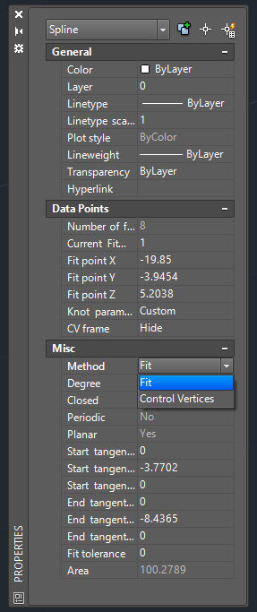

Your splines are all set to "Control Vertices". I changed them all to "Fit" and then I was able to Loft with no problem.
Thank you! That did it. Solved. :excited:
