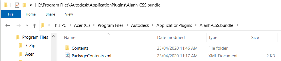

BIGAL Posted November 1, 2020 Posted November 1, 2020 Look into using a bundle approach its pretty straight forward just need a sample one to copy how its put together. See if you have one now else can provide more detail about what lives in what directory. Quote
