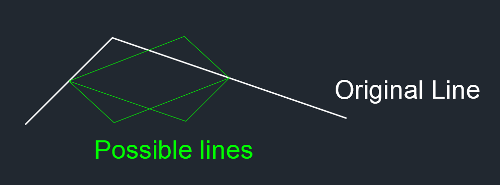

Hi all,
I have a cad file where there are many polylines with 3 vertices(not exactly 90d), and I have to copy the same polyline and paste to the start and end.
its like creating closed polygons.
Any code, help or advise will be appreicated very much.
Thanks

CADWORKER
Tharwat Thanks for your efforts and response.
Might be my request was not clear so I have attached a snap for better understanding of my requirement.
Thanks once again

Jonathan Handojo
The outcome can be of three possibilities (if on the same plane, otherwise infinite possibilities). You need to be clearer. What you want seems to be the parallelogram rule. I could be wrong.

Tharwat
You said that the objects are polylines in the post and the program that I posted in my first reply also mirror the polylines as shown into your image as the final result unless you are referring now to line objects and not polylines !

CADWORKER
Its my wrong, Actually its not lines its a polyline.

CADWORKER
14 hours ago, Tharwat said:
You already now have two programs, the first program that I posted works for polylines with three vertices and the last one with work with connected two lines.
Have not you tried any of them to know how they work?
I tried, both the codes; what I was looking was copy from mid to start and end of the plines and not the mirror.
