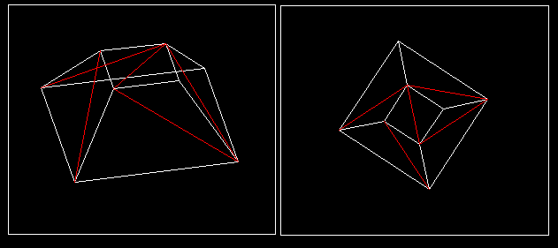

Sounds like TIN modelling, then can get volumes etc. Have you looked at TIN's Triangular Irregular Network. There is some free software here "TriangV0.5.9.lsp" version may be newer.

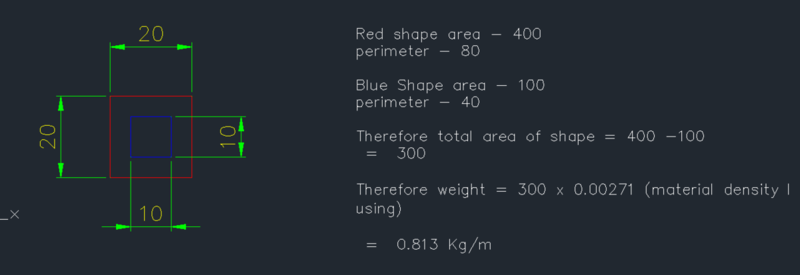

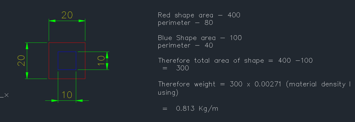

See below for  a quick eg of what I am trying to do ie: Work out the weight of a simple 2D shape
I can do it all long hand but want CAD to do this for me in a quick button press.
Basically, I want to be able to select the outer shape (red) and then select any inner shapes (blue). CAD will then work out the area of the shapes and then also the weight. Once known, give it to me on an MText input so I can put it on the drawing.
It is simple to do when using square shape but when shape is irregular, it is difficult.

Assuming the shapes are closed polylines you can use the area command with the following sequence.
Give the area command followed by A (add) then O (object) pick the outer boundary, hit the space bar then S (subtract)   then O (object)  and pick the inner boundaries and you will see the Total area = ... .   Swipe the area value and use Ctrl-C to copy it to the clipboard then give the mtext  (or text) command and paste the area value with Ctrl-V you copied.  Of course the process could be streamlined with a vlisp program.
A TIN of the shape would be like the pyramid solid option. You can then get a volume. A function of the difference of 2 surfaces.

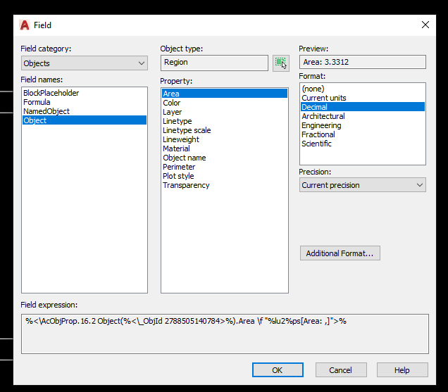

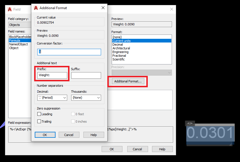

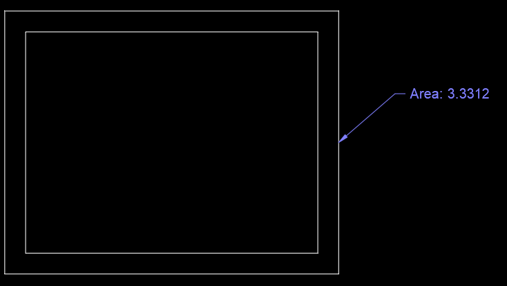

This could be done easily with Lee Mac's Fieldmath function and add to a Multileader. First create an Area field in the Multileader, Then use Lee's function to add the material density constant to the Area. You will have to add it as a separate text then copy it into the Multileader below the original field. When copying you can used right-click > "Edit field" and add a prefix to the Fields. Then just add the Density line into it manually. I'm sure this could be done with a whole Visual / Auto LISP solution, but I don't have time to code it for you.
