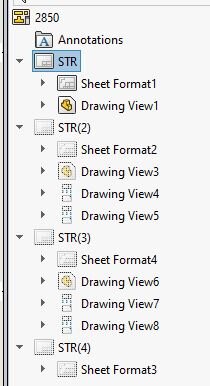

I'm hoping someone can help me here, I'm a fairly new user. In my current drawing the sheets & view icons for some reason have been showing faded.
I believe this means suppressed? I was hoping for any suggestions here as to why this is appearing, thanks in advance.

Is that just becuase you are currently looking at sheet STR? if you active one of the others (so its shown in the viewport) it will become unsupressed?
