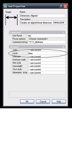

stevsmith Posted February 9, 2009 Posted February 9, 2009 stevsmith, What do you mean by setting up correctly, do you mean naming tool palletes, or is there somenthing i don´t know about?? Once you have uploaded them to the tool pallet if you right click on the block you want to drag in select proporties and a new menu will come up. You can set the scale, rotate on insert, set which layer you would like it to come under. I have all my dimensions in the tool pallet and when i insert them it automatically puts them in a dim layer. Quote

stevsmith Posted February 9, 2009 Posted February 9, 2009 I find the rotate command very handy. i design balustrades, so when i draw a handrail and put in the brackets it asks m what angle or snap point i can specify the rotation. Also, I have my title block under "auxillery scale" set to "dimscale" all my dims are set to 1:10 for a3. When I chnge the dimension scale it automatically adjusts to suit my text height. So for example i want my drawing at 1:20 i change the dim scale to 20 and the border sets up the text and border to suit. but make sure the text height is set 1st. If you know what I mean. ill post a pic if anyone requires it. Quote
michaeloureiro Posted February 9, 2009 Posted February 9, 2009 Amen to that Steve. is there a way to get all of the blocks in a tool pallete inserted in specific layer? Quote
