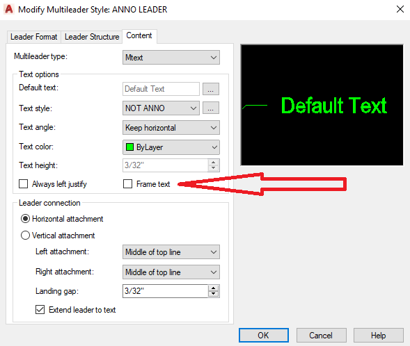

How can i able to combine M-text with leader and box as i do it manually by coping leader and box and then copy text and paste it inside box i am also attaching the dwg here

Without looking at your drawing...
Have you tried making a block with your Mtext/Box with Attributes then making a MLeader using the block?
You can make multiple versions with different size boxes too...
Just a thought before getting into programming..
Simply modify or create a new leader, and check the box shown in this image.  and bobs yer uncle.  The frame automagically adjusts to the text no matter how many lines or how long the text is.
for this first i should create Mleader after that this will happen
You can modify an existing leader but, unless you want ALL your mleaders with frames you will also need leaders with no frames, right?
