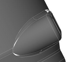

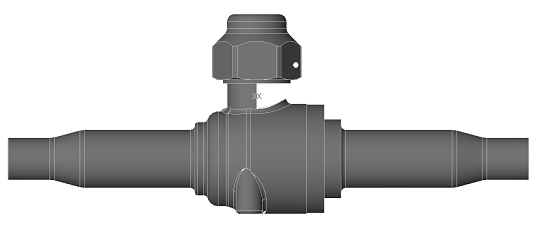

If in Autocad i open a new drawing with "acadiso.dwt" template, and save it as .dwg with the imported valve, Revit won't process it properly:
A lot of surfaces will go missing, it'll be laggy, and throw some error messages.
image.png.46a00c8fcc213a80331cf516dcba86aa.pngimage.png.3411a1d32a79dc6a5eb14c29d29e60d7.png
I tried many settings like save it in .dwg 2018 or change properties of the STEP itself, etc. Sometimes there's a change but its never perfect

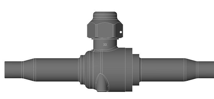

But accidentally, i noticed, that if i choose "acad.dwt"  as the template of the new drawing, than the Revit import will work perfect and won't give errors...
