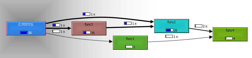

Call Grind for Lisp (CG) is a Lisp application aimed to help profiling of lisp programs running on IntelliCAD, AutoCAD, BricsCAD and alikes. If you are in need of determining the bottle-necks, the time consumed for specified functions , visualize call diagram of your lisp application you may find CG useful.
CG collects data (time consumed by each function and call stack) at runtime (dynamic analysis) and creates “call grind” type output to be used by CacheGrind system (credit goes to authors).

Thank you so much for this program, it has allowed us to profile a large AutoLISP application and find out where the bottlenecks were.
A small fix I made (at least on Windows) was on line 271:
(setq fname (strcat fname "\\callgrind.out.lisp"))
I had to add the \\ because "MYDOCUMENTSPREFIX" (in my case: "C:\\Users\\<user>\\Documents") does not end with them, so it would save the file as "Documentscallgrind.out.lisp".
I also added/fixed the provided Regex to support VSCode out of the box, as this is the main environment we program in because of the official AutoLISP extension:
