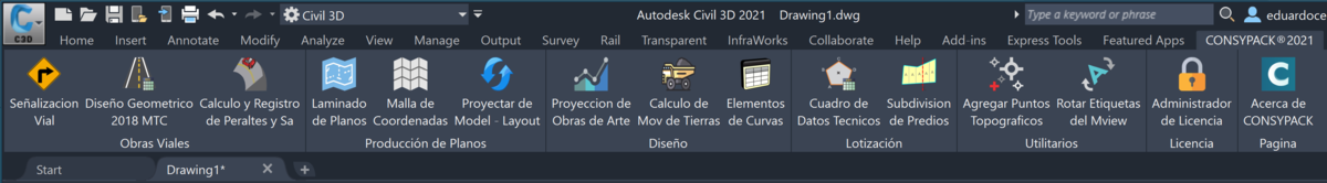

Bigal,  I HAVE NOT FOUND A LOT OF INFORMATION ABOUT THIS AND THE Q ALLE ONLY HAS BEEN TO BE ABLE TO LOAD ONLY 1 LISP
AND INSIDE THE ADD INS MENU AND WHAT I'M LOOKING FOR IS TO LOAD MY OWN MENU
Menuload your menu then make sure save Workspace, else may not appear on restart,  we always has a workspace of user name stops stuffing up default ones.
Appload go to "start up suite" and add your 1 lisp.
Did this for multiple menu, ribbons etc all in CIV3D had 1 lisp but it contained like 20 defuns. Rather than load 20 lisps.
