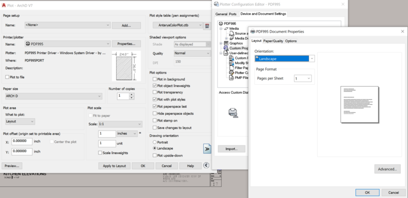

Please need help. I am trying to format a sheet, ARCH D, using Pdf995 from autocad 2018. When I change to landscape mode in printer properties I get the error below.
Also  attached the screen shot.
When it is in regular default portrait mode it works.
How can this be solved as I need to create pdfs in landscape mode for city submittal.
I also use a plot style while printing.
The drawing orientation option for landscape does not work. I have to go in the printer Pdf995 options to change to landscape mode.
thanks
Job: - Error(s) Did Not Plot
Job ID: 6
Sheet set name:
Date and time started: 1/6/2021 12:54:13 PM
Date and time completed: 1/6/2021 12:54:13 PM
UserID: Ratna Khilnani
Profile ID: <<Unnamed Profile>>
Total sheets: 0
Sheets plotted: 0
Number of errors: 0
Number of warnings: 0
ERROR: No Matching Media

We also use PDF995 in order to make PDF/A compliant drawings.
This printer driver works well with BricsCAD but we cannot get it to work with Landscape drawings in AutoCAD 2019.
As a workaround, you can print it in Portrait and then rotate it or print it in Landscape using the DWG_to_PDF.pc3 autocad default PDF driver. DWG_to_PDF.pc3 cannot print PDF/A compliant pdf though.
I think older builds of PDF995 comes with PDFedit995 also installed, which is another software to control de PDF995 behavior. It has an option to 1-click rotate de last printed PDF.
