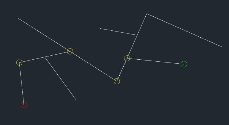

Hi all,
I've been struggling on this to no avail, so I thought I'd brought it up here. If this has been asked somewhere, I apologise for not being able to find it.
The goal I'm aiming to achieve is to write a function that returns a list of points (in sequence) trailing from one end to another end of a chain of lines. For better clarity, I'm posting this image below:
What the function should return is the points of the green, yellow, and red circles in order. I'm thinking that the function accepts three arguments (maybe 4 if some flag is required): a selection set, the starting point (green for example), and the ending point (red). I would prefer it if the function can work up to some tolerance (1e-7 perhaps)
Here are some things that will always be fixed:
1. The selection set are only lines, polylines, or both.
2. The polylines will never have any bulges at any point (even if it does, I'm only interested in the points).
So far, this is my attempt, but it's never consistent:

I'd appreciate any help... Thanks.
Has been done before, think of your car GPS at top level. If you get correct google search you will find, start with "shortest path"
Thanks guys. By looking at Ron's post, I was able to modify the function to suit my needs. But that certainly was a very brilliant approach, and without it, I wouldn't have been able to get there.

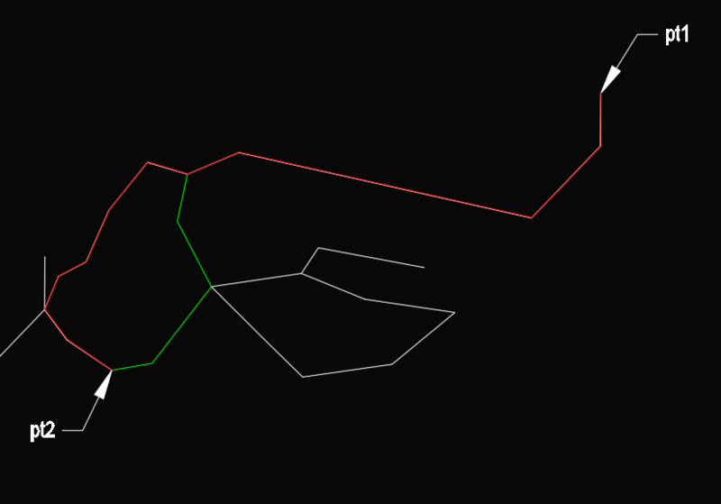

Nice job @Jonathan Handojo  👍 .. I did a quick test and it looks like you have a bug. The green route is shorter.
(defun c:foo (/ a p r)
  (foreach e (mapcar 'cadr (ssnamex (ssget "_X" '((0 . "line")))))
    (setq p (cons (list (cdr (assoc 10 (entget e))) (cdr (assoc 11 (entget e)))) p))
  (setq r (treepath p (getpoint) (getpoint)))
  (setq a 0)
  (mapcar '(lambda (r j) (setq a (+ a (distance r j))) (grdraw r j 1)) r (cdr r))
  (print a)
test.dwg
