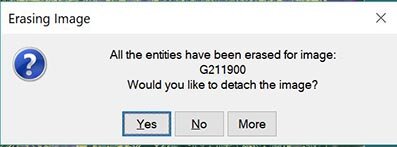

Jest Posted March 9, 2021 Posted March 9, 2021 When I want to delete a lot of selected images from drawing, I must confirm deletion for each image again.... So.....if I selected 100 items and wish to delete them, I must press Yes 100 times. There is no option to confirm deletion for all selected. Even cancellation is not possible. I have to hit Escape 100 times anyway....!?..strange. Is there a way (lisp or macro) to simplify and speed-up this process? kind regards F. Quote
ronjonp Posted March 9, 2021 Posted March 9, 2021 I don't get that alert ..maybe it's a variable? Quote

Least Posted March 10, 2021 Posted March 10, 2021 (edited) I would bet that you have raster design installed? If so you can change a setting to 'always detach' when an image is erased. Raster Design defaults to 'ask before detaching'. It used to bug me until I found this simple fix. https://knowledge.autodesk.com/support/autocad-raster-design/learn-explore/caas/CloudHelp/cloudhelp/2021/ENU/AutoCAD-RasterDesign/files/GUID-87AF47BD-DC9A-449E-869B-9B9B60AD628D-htm.html#GUID-87AF47BD-DC9A-449E-869B-9B9B60AD628D unref.lsp here https://forums.autodesk.com/t5/visual-lisp-autolisp-and-general/finding-loaded-and-unreferenced-images/td-p/1908251 is great for finding and unloading the unreferenced images. Edited March 10, 2021 by Least Quote

Jest Posted March 10, 2021 Author Posted March 10, 2021 I do not have Raster Design installed....just Autocad Map 3d 2021.... Quote
Least Posted March 10, 2021 Posted March 10, 2021 1 minute ago, Jest said: I do not have Raster Design installed....just Autocad Map 3d 2021.... i expect there is a similar setting. Have you looked? Quote
Jest Posted March 10, 2021 Author Posted March 10, 2021 Yes, I finally solved my problem. I have found settings here: https://knowledge.autodesk.com/support/autocad-map-3d/learn-explore/caas/CloudHelp/cloudhelp/2016/ENU/MAP3D-Use/files/GUID-2AE006C6-C2C9-4D47-B365-A64A21801E1E-htm.html Thanks for your advice "Least" ! Quote
