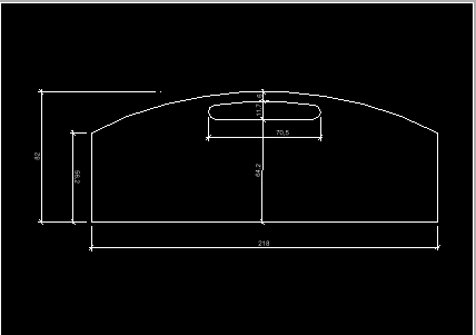

For me went to a layout if mview exists erase, then do MView 0,0 297,210, then click inside do Zoom E so your objects appear at a "FIT" scale they need to be a bit smaller as you have what is known as clip limit around 5mm on edges. So I typed zoom 1xp, and it is now perfect. Just plot extents, scale 1:1 sheet size A4. The 1xp says rescale the window to true size. Try a couple of sizes 4xp, 0.25xp and you will get the idea. Turn on the toolbar VPORTS when you go into a viewport the scale will be displayed in the box.
