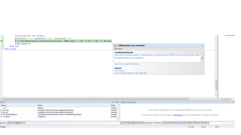

Dear all,
I need your help.
I have draw and create a block (I draw it in autocad not with VBA)
I want to insert this block using VBA.
I use visual basic 2008.
The file i use is TEST.dwg
The name of the block is ENA.
My code is:
 Public Sub Form1_Load(ByVal sender As System.Object, ByVal e As System.EventArgs) Handles MyBase.Load
        Dim acad As New AcadApplication
        acad.Documents.Open("C:\Users\dCap\Desktop\TEST\TEST.dwg")  ' The file i use
        acad.Visible = True
    End Sub
 Private Sub Button3_Click(ByVal sender As System.Object, ByVal e As System.EventArgs) Handles Button3.Click
        Dim a As AcadBlockReference
        Dim points(2) As Double
        points(0) = 0 : points(1) = 0 : points(2) = 0
        a = cad.ModelSpace.InsertBlock(points, "ENA.dwg", 1.0#, 1.0#, 1.0#, 0, False)
        acad.Update()
    End Sub
The error i get is in the image.
us i told you the name of the block is "ENA" i also try "ENA" and"ENA.dwg"
Any help ?
Help in advance

Hi,
I'm not so expert with Visual Basic, I'm using directly VBA Application directly used with Autocad, not LT version.
In any case inside the code a = cad.ModelSpace.InsertBlock(points, "ENA.dwg", 1.0#, 1.0#, 1.0#, 0, False) seems you are using cad instead acad.
In addition you already have created the block inside TEST dwg or you are trying to insert a block as dwg ?.
Bye
I have already create the block ENA in the TEST.dwg
Thanks
cad.Modelspace  is not equal to acad.Modelspace as provided by Peterpan
Dear,
Thanks for your responces.
I  already use this comand in the beggining of my code
    Dim cad As AcadDocument = acad.ActiveDocument
