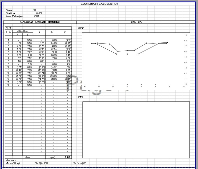

need help from senior here, as my attachment file from cad to output excel table, i need to create report ( coordinate and area ) from all closed polyline has text as an ID
thanks in advance
AREA.dwg REPORT.xlsx

thanks mate, but it seem doesnt meet my need, cause i need to identified each closed polyline with text inside the boundary, cause i want to create report each boundary area and each boundary polyline

im using civil3D also, the report what i need should meet criteria report by our local goverment, so excel with chart that show list coordinate and calculation of end area should in excel format. in civil 3d i cannot show list coordinate and end area calculation, maybe im missing for that one.
